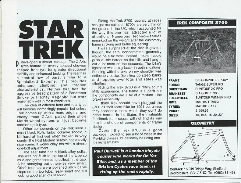

So, I've finally managed to scan the MBi article with the Trek 8700 test.
Theres a lot of good stuff in that May 1991 issue of MBi ! - it's the one that also has the Orange Aluminium "O" test, a Manitou test, GT Karakoram in red, and a chance to win a Trek 8700!! :shock:
Reading through, I think the test bike is Specced with the Deore XT in the pictures as it's the testers own race bike (Paul Burwell sponsored by Brixton Cycles)
The actual review is for the Suntour/Bullseye equipped version.

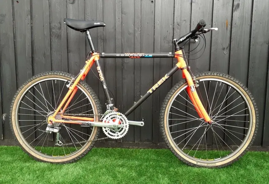

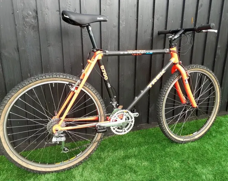

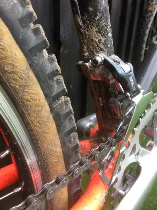

I'll be adding so pics this evening - but, it's now running with it's original spec Bullseye 32H hubs on Matrix MTII rims (a big thank you to Retrorider_IT for these
I'm also going for a  Cook Bros Racing chainset, but as Once a Hero mentioned earlier in the thread, it looks like I'm going to need to source a 132mm or similar bottom bracket as it doesn't clear the chainstay with a 127.5mm one.
Ironically, I bought a 122mm Shimano UN55 bottom bracket thinking that a reduction in the current gap to chainstay wouldn't be a bad thing.  :facepalm:

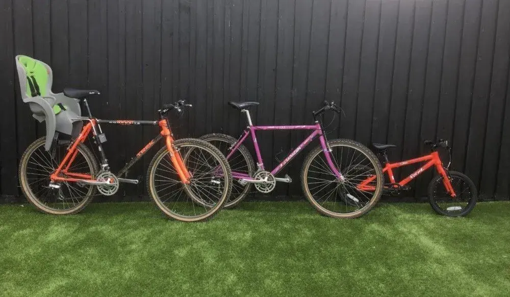

Long term, It's current justification in the Fleet is as 'Child Carrier' as my wife uses the Kili Flyer when we go out as a family. The sooner I can use the Tag Along with the youngest, the better!

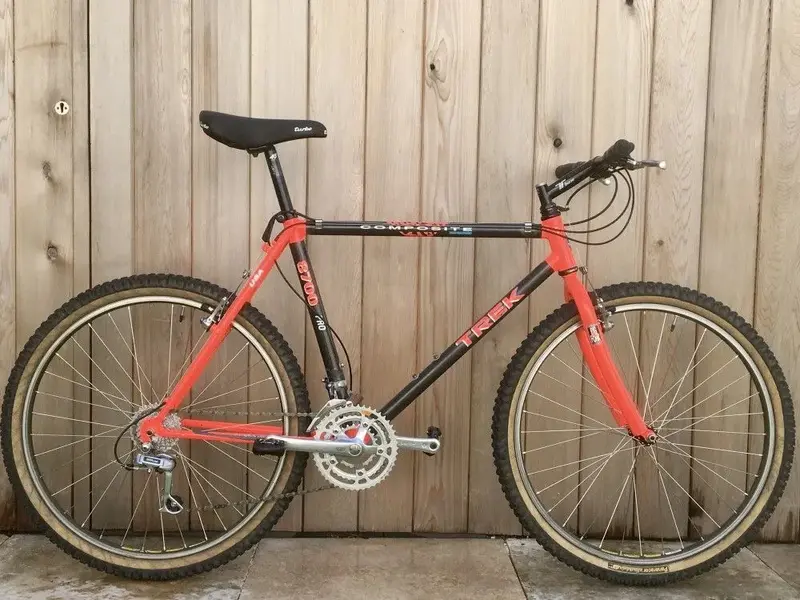

I've no plans to do the Paint or Lacquer on the Carbon as yet, mainly because the original condition and brightness of the Orange is very good. I'd also be nervous about re-creating the 'spidering' of the black on the original Neon 'Conch'.... but I've noticed you mentioned a technique in Retrospud's 8900 thread that I'd be tempted to try some test pieces to see if it was possible.
Currently though, it's ride and Enjoy! (preferably without the child seat!)

In the meantime, here's that scan from May 1991 MBi.
