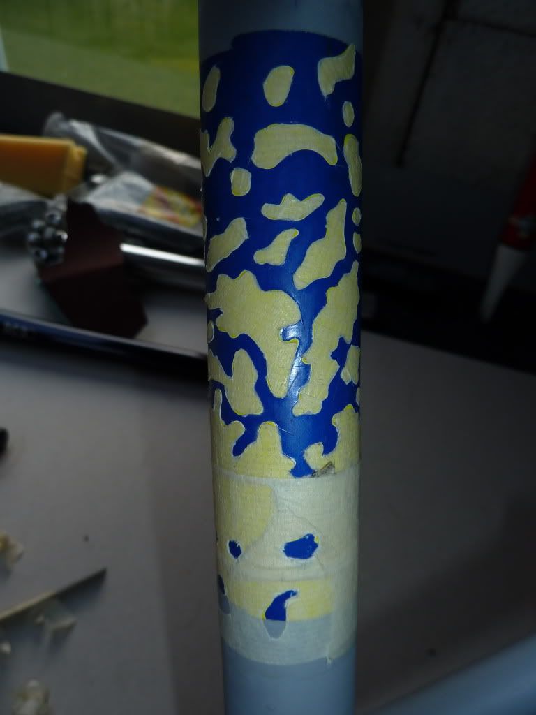

Latest update on the Bravado LE Team Scream jobbie... I've found a good match for the blue, but as yet haven't found a good dayglo yellow.
I must be a masochist as I've decided to individually mask each splatter bit to keep the right effect. It's taking a long time!

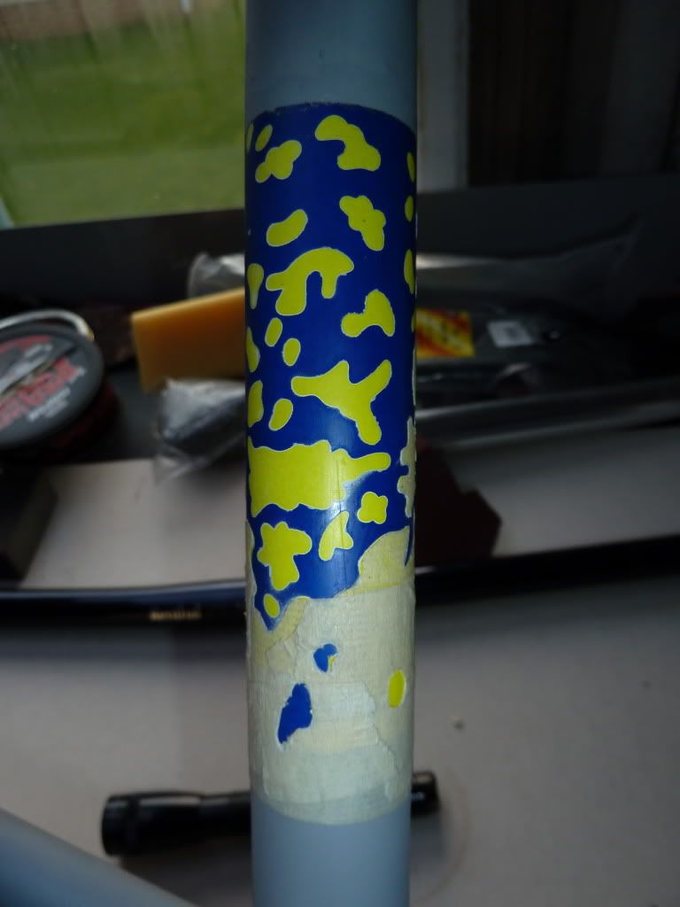

Have nearly don the seat tube section... which just leaves the down tube and both seat stays. See pics below -
The pictures do show up every little fault and I'll ensure I tidy these before applying paint...
It has also dawned that i will have to do the reciprocal when the yellow needs painting...

You are being very thorough. I think doing a rubbing and making a stencil would be easier or at least a good back up plan. Blue or yellow first then the other. This man agrees...

Masking film would be much better to use than bits of tape - it is a soft re-positionable plastic film you cut it with a craft knife (or scalpel) if you trace what you have you should be able to cut (carefully) the yellow and blue stencils in one go.
http://www.artistmaterial.co.uk/product ... -Film.html
You only need to cut through the plastic - if you don't cut the backing sheet the other decal will remain intact.
