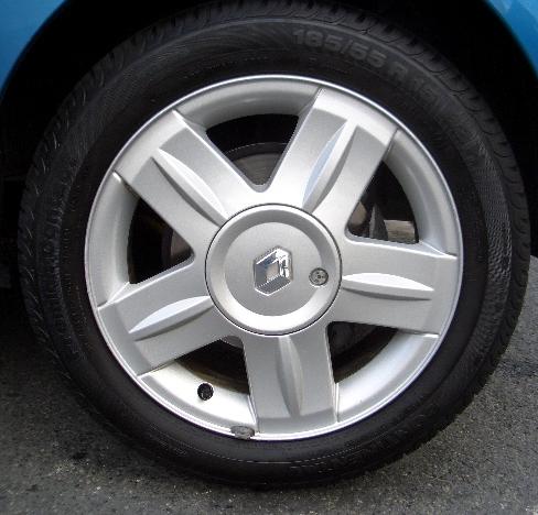

It is a Clio II facelift version, the one before the current shape. Basically, the one Renault are still shifting but have now called it a Clio 'Campus'. Its a 15 inch alloy so finding them on ebay amidst all the 172 sport wheels is a pain. The ones I have found on there really have seen better days. I have seen those £250 wheel only packages and they are tempting though... :roll:

KDM, the spare is a steely. I could run the steely until a straight alloy turns up, but the bearing is shot so may as well at least have matching wheels until I get both bearing and wheel replaced. I dont have a picture to hand of mine, there isnt any visible damage anyway as its not really noticable to the naked eye. It is one of these though, running a 185/55/15 tyre:
