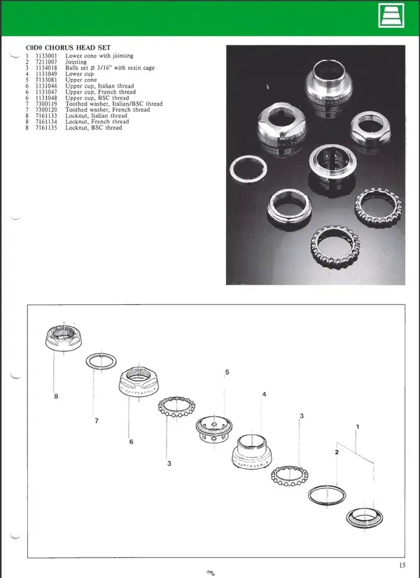

Is it possible to distinguish between the heasets visually? The Athena on Velobase appears to be stamped Brev.-Int.-Campagnolo like this one. The Chorus is stamped Campagnolo - Brev - Int.
Is that difference in marking meaningful?

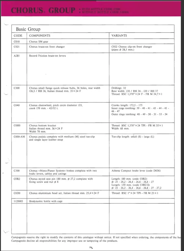

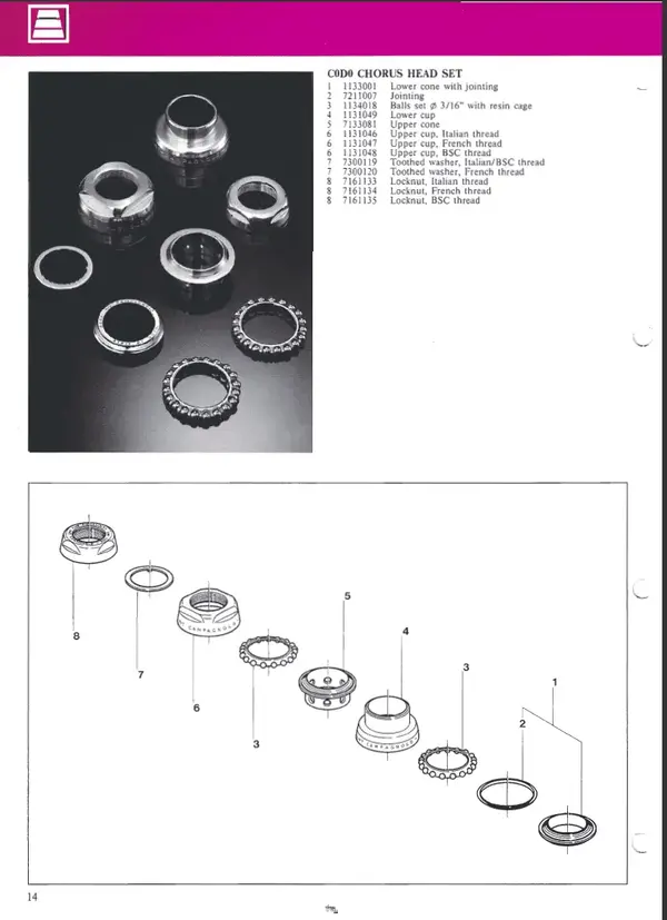

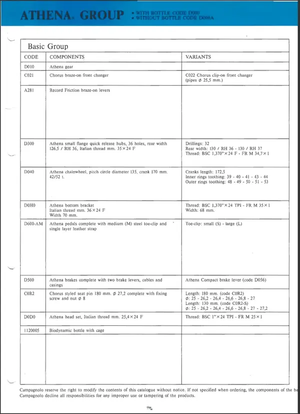

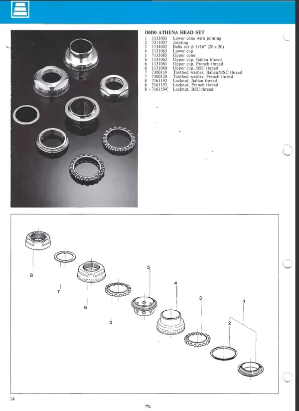

CDA, Chorus & Athena parts from the campag spares list. Any help??

So Chorus and CdA are the same C0D0 headset. Athena is a lesser D0D0
The pictures aren't really detailed enough to tell the difference but I think the clue is possibly in the way the Brev, Int and Campagnolo are stamped unless that was just dependent on the tooling they had set up on the day...
Re: Re:
I think the clue might be in the actual individual items part numbers?
If they have different Numbers then they are in some way slightly different. Obvious I know, but but thats the best way I can explain it.
