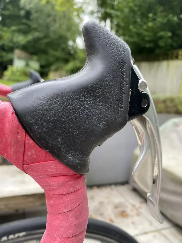

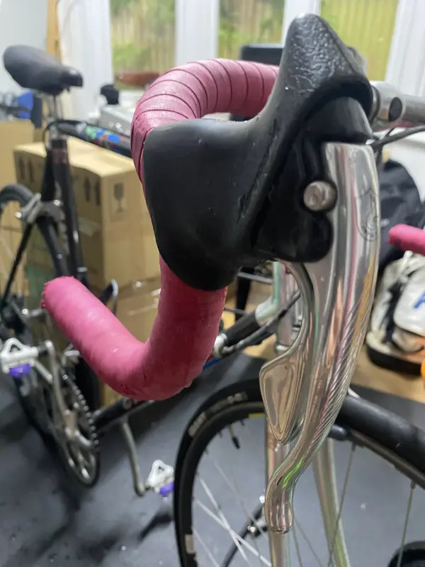

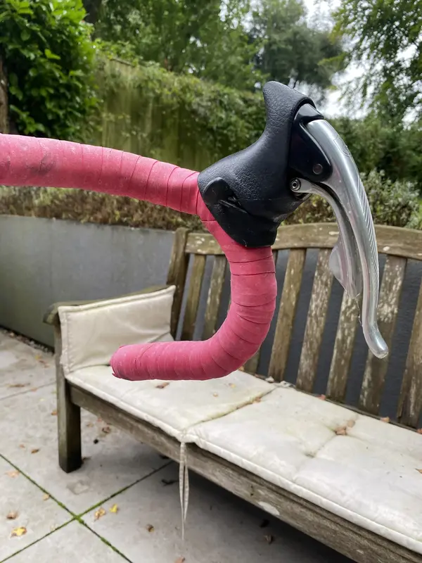

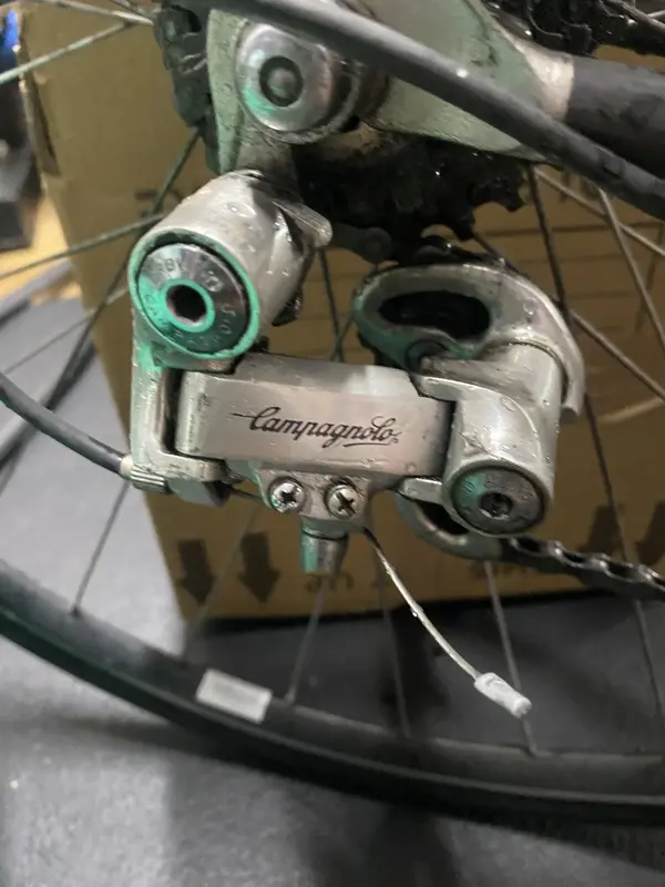

Just picked up a Cadex 980c in what looks like very nice condition considering it has be standing outside for a while...long enough for the tyres to be completely flat! It has a full Campag groupset and wheels but while Shimano is easy, I cannot recognise Campag models. Can anyone help?

I think the RD and levers are Record, but in typically confusing Campagnolo fashion, the brakes are Chorus.

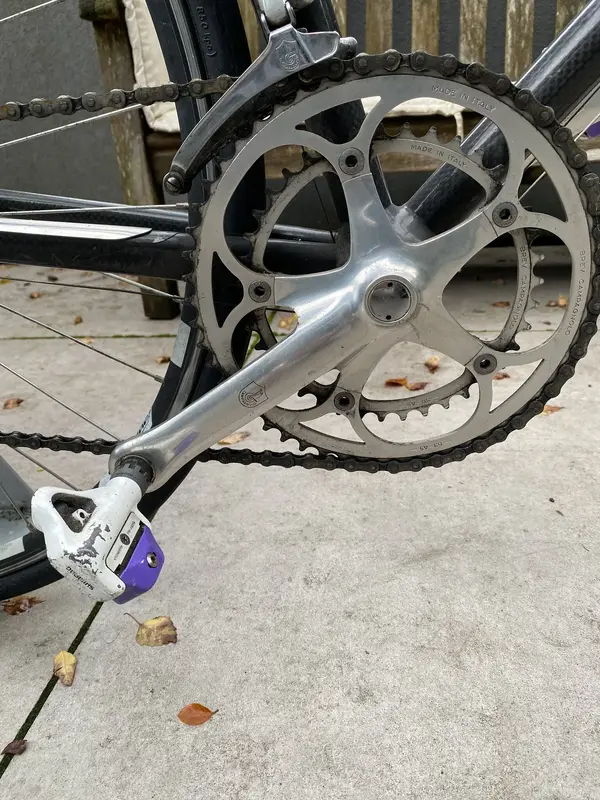

Just to complete the groupset photos. Here is the crankset and front mech and the other side of the brifter. Also the whole bike to give some context. I am trying to research some more info on this bike . I cannot find any that were specced for Campag, all see to be Shimano 105 or even Dura Ace.
I have the serial number as GJ 9003 and will see what the internet throws up.

And I'm 100% sure the shifters are Record, and the brakes are Chorus - the only Record brakes at this time were the Delta ones.
