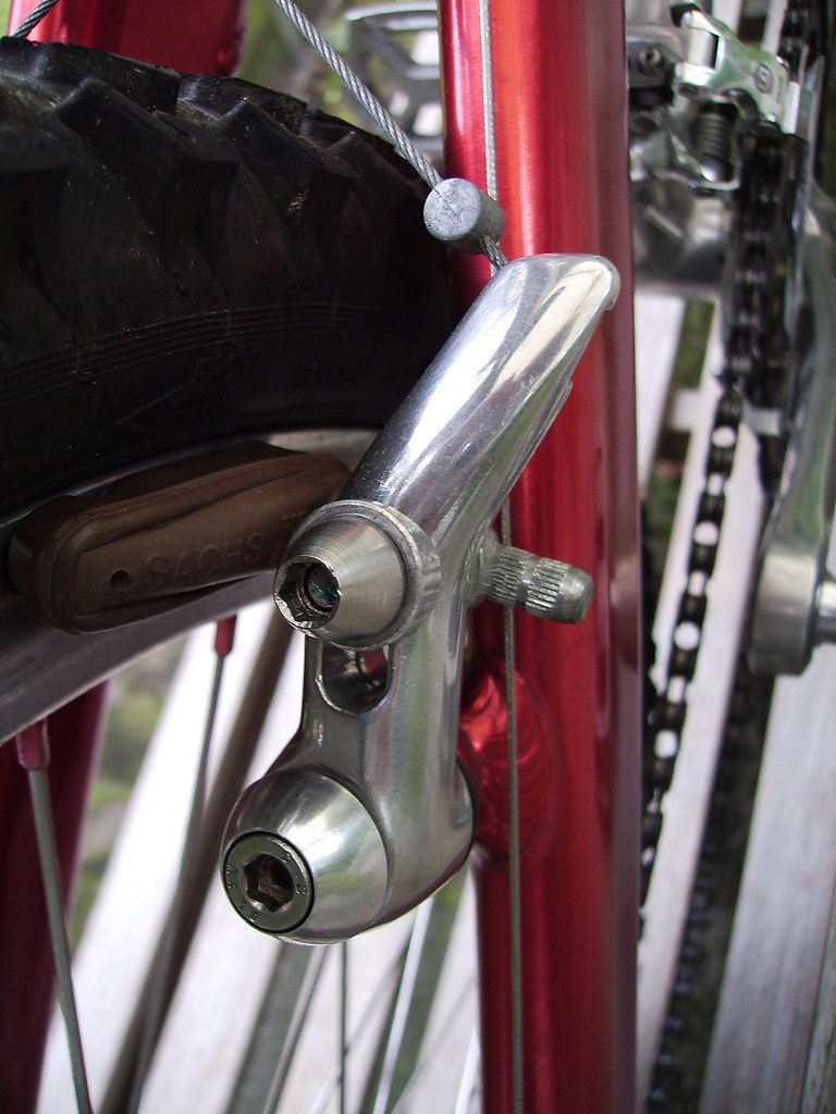

Can anybody tell me about these canti's?
They are similar in construction like the Quarz' on my Verlicchi, but fitted lower in the line up.
Got my hands on a FUNK specced with New Success (top of the line, predecessor of the Quarz) while ago. The cantis were similar to the Quarz ones. On the FUNK the former owner substantially overtightened the bolts that hold the pad, causing the aluminum parts and the canti itself to crack. Design not as foolproof as say XTII.
The black aluminum bit that sits with a very narrow gap next to the bolt that hold the canti (and with which you adjust springtension) can touch the canti, for example after slight deformation caused by overthightning. This will influence the brakes performance and/or adjustability. In this case you will have to add an washer between bit and canti and problem is solved.
