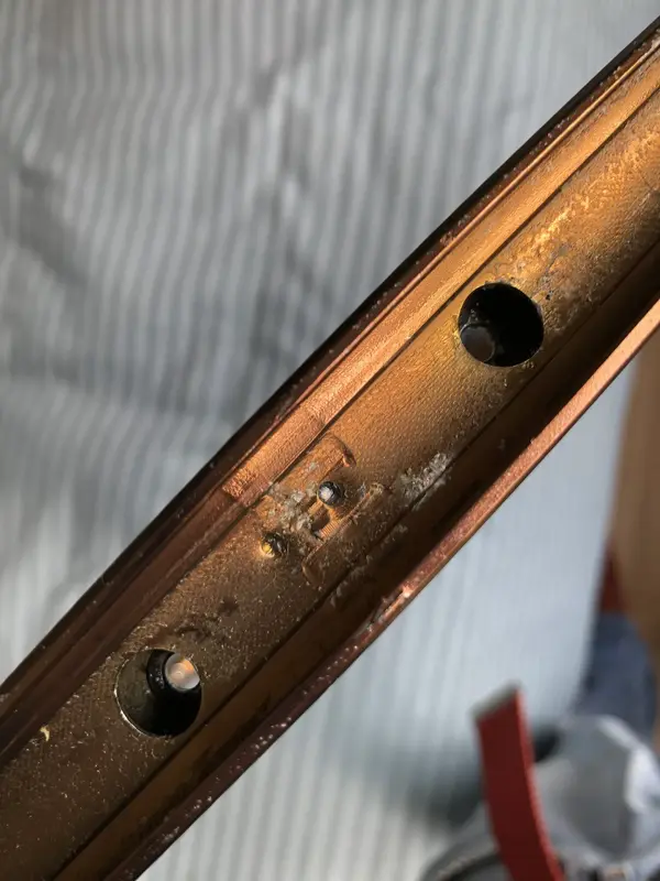

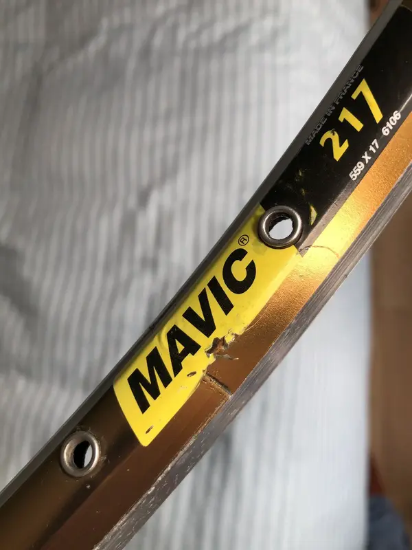

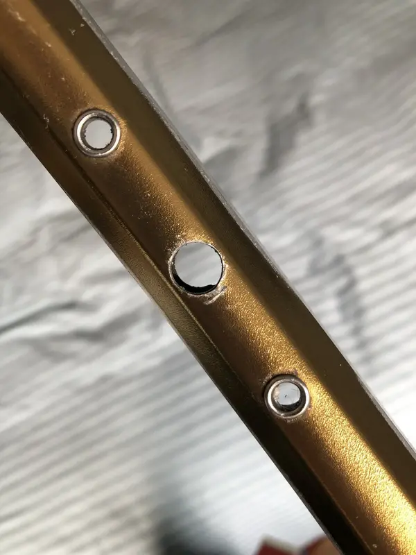

So this turned up in the post today after much looking for a matching rim and then discovered on closer inspection it looked like it had a crack in it. once rim tape glue had been cleaned off, it’s confirmed As per pics. (Seller gave full refund no hassles 👍🏼)
As it’s just on the outer wall, and then mostly for lighter use, could I get it fixed/reinforced/glued/welded or anything do you think ?

At your own risk:
Drill some small holes at each end of crack.
Rub the anodising down to raw alloy and use a strip of carbon fibre cloth and epoxy.
Good quality epoxy is wonderful stuff.
Then follow @pete_mcc advice Just put the rim tape back on and drink so heavily you forget the past 24hrs and you’ll be all good
And check it reasonably frequently until you're sure it's holding.
Disclaimers: I presume only moderate usage is planned. Also presuming there is no cracking on exterior surface of rim.
I’m not an engineer, depending on what kind of riding your doing (light nothing fast) surely this would still be workable 217 we’re double walled? Someone please correct me before someone dies xD
