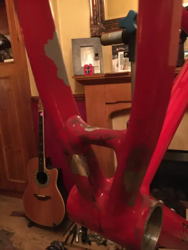

Apart from a few areas in the image, the rest of the frame is immaculate, its just tedious with 1200 wet and dry trying to ensure its ok for the Etch Primer, the top part has been "Etched" with a really fine paint brush. Being honest I have much more patience with mechanical things than this task, I will try my best as it does not warrant a full re-powder or paint, also there is no way to find 1994 M800 decals like the originals.

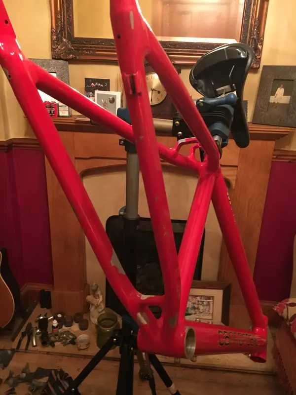

It's becoming "obsessional" ! - What is it with bikes! I have enough push bikes and motorbikes, just one more for that nostalgic longing for those long-gone moments in history with that one bike. (Anyone else have those moments?) (n+1) 🤪
