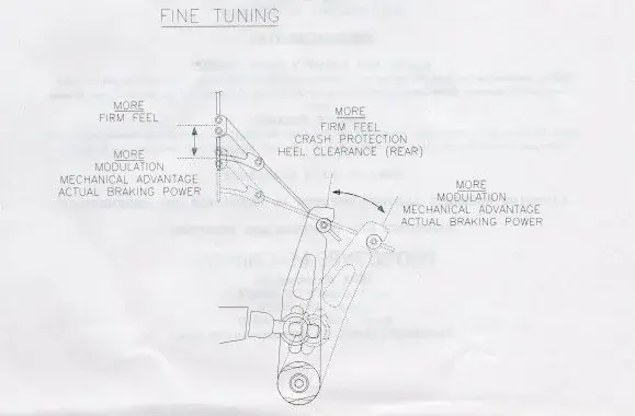

...perhaps a little help for the most powerfull set-up...
There have been a few disscussions on canti setup lately, my setup seems to be a bit 'marmite' :lol:
WD :D
