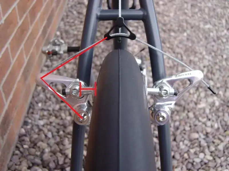

I always set mine a couple of mm from the rims and have the pulley bit higher up. I thought that gave more leverage. can't show pic i have v's on at the mo.
That diagram shows to have them lower right and at a greater outward angle, or am I reading it wrong.
dont worry about anything else too much, this is the only thing you need to worry about with cantilevers. the distance between canti arm and rim under braking, closer = less power
For the most powerfull setup you need to get the moment (crank X power) as high as possible. To get the moment as high as possible you need to get the angle through the pivot point, the point where the cable is attached an the cable straddle thiny at 90° at the time the brake pad is touching the rim.
Bleudazzler, I hope you don't mind I used your photo to draw in the angle I'm talking about...
It's the same for V's... so indeed the distance is important. In case of V's the only way to tune the angle... with canti's you can play with the straddle also...
