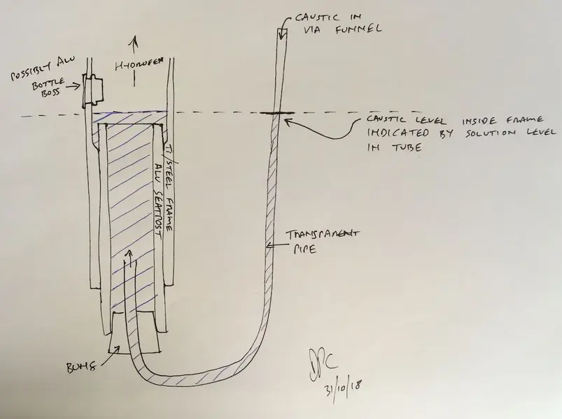

Also..other thoughts on the caustic feed...
To save having to disturb the alu sleeve in the BB shell, how about making a u-bend feed for the caustic?
This way you can accurately set the level of the caustic solution in the seat tube,and easily flush/drain it out to refresh.
As long as there is a route for the hydrogen to vent, it should be relatively clean and safe:
All the best.
All the best.
Danson
That's a marvellous post - thank you so much for taking the time and trouble to pop up that suggestion! I like the fact that you've copyright signed it!

Sadly, it transpires that both the butt at the top of the seat-tube, and the sleeve within the b/b shell are both aluminium, so I couldn't have used this marvellous U-bend suggestion, as it would have eaten through the seat-tube collar rendering it unable to insert a seatpin! This is why I've been so slow to really make progress with this, as it's been really bloody hard to work out whether these were ally or not!
Once again, many thanks for taking the time and trouble to draw the schematic. It's marvellous...

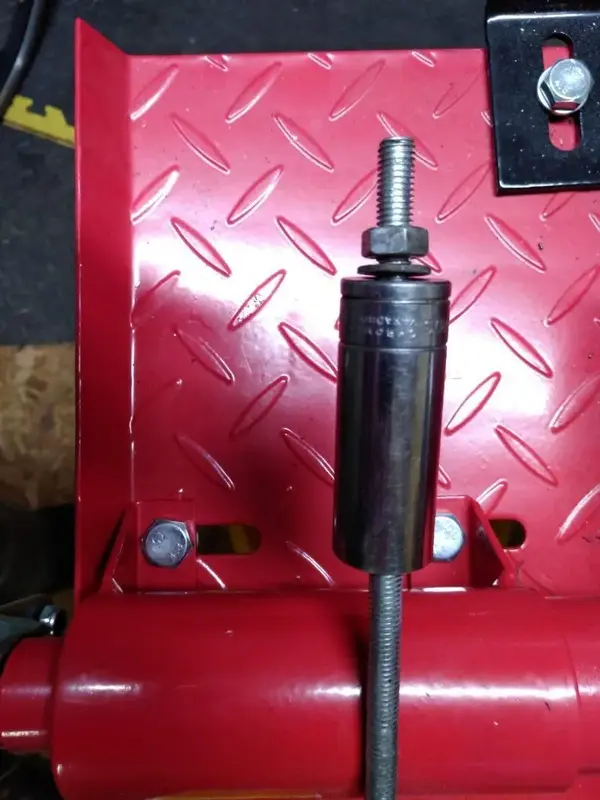

Ok, the solution was fairly simple as it turns out. I'd already worked out how to the seatpin to the butt of the seat-tube, but it was getting it past the butt that was stumping me.
The framebuilder built a custom slide hammer, using a long'ish steel threaded rod - looks like a low-grade wall tie to me of about M6 / M8 thread - with some washers and a nut on the long end, which were just narrow enough to be fed through the 27.0mm seatpin remnant, and with an old socket and nut on the pulling end.
Some alcohol to dissolve the foam, and the remnant could be lifted up to the bottom of the butt. This is the clever bit that I couldn't think of - he then used some special metal working pliers, that are particularly long to squeeze down on the broken end of the seatpin, in parts breaking it, and in other parts bending it in, to make nicely more narrow than the 27.0mm diameter of the butt.
Once the top of this had been fed and pulled into the opening of the butt at the bottom, some lube and the action of the slide hammer was enough to bring the corroded remnant out through the seat-tube opening, as if you were simply removing a stiff seatpin. It was some effort, but relatively straightforward apparently!
A metal cleaning brush on a flexible hammer extension was then used to poke down the seat-tube and clean out anything that might have been remaining on the inside of the tube.
Overall, a lovely job. No corrosive's used. No damage to the frame. This had even defeated the seatpostman!
