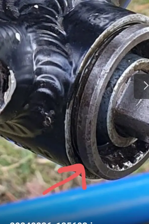

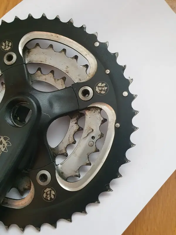

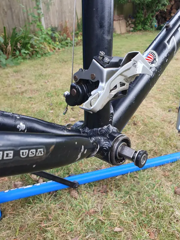

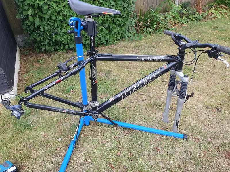

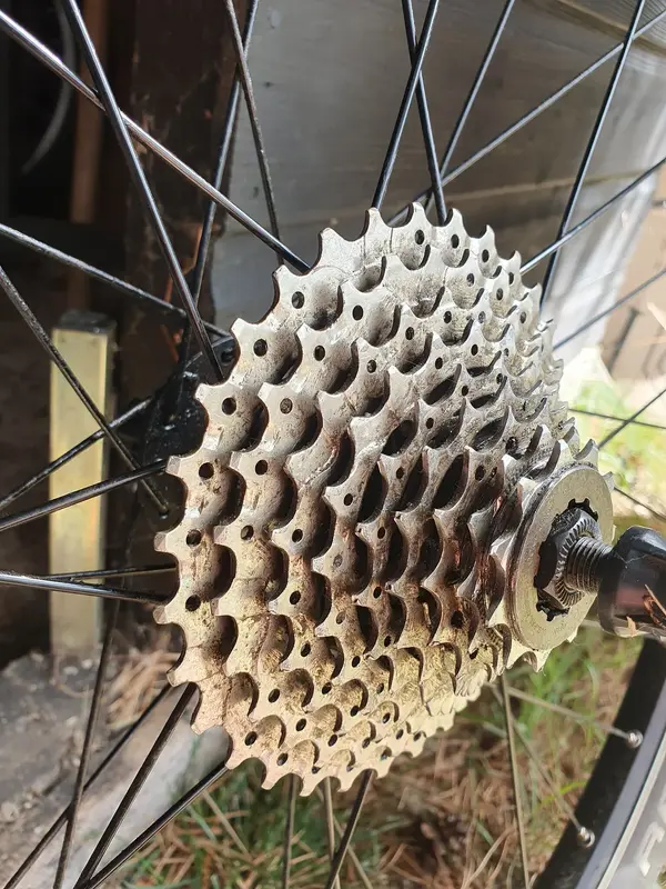

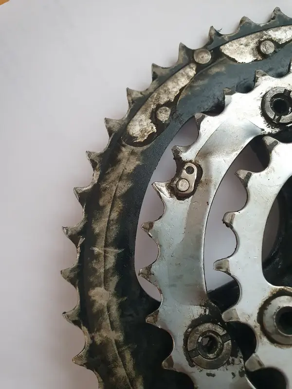

HI all. Thanks for responses, wasn't expecting that..... so pics attached. One problem might be in eagerness with my £40 new toolkit started stripping back. Chain been taken off but looked knackered. Rear wheel/cassette looks pretty new and feels ok. Large ring awful but it slipped in middle. Also took shot of BB which I removed and cleaned up. No matter what I have to change those rings. Cheers stu

Cassette - sprockets 5-8 look heavily worn to me. If you start with the largest cog - that's generally how they all should look, but as you move down they have progressively sharper teeth. They should be 'blades' rather than 'points'.
Middle and outer ring on chainset need replacing. Granny ring looks OK.
