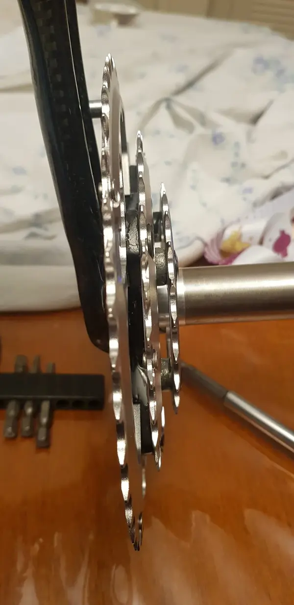

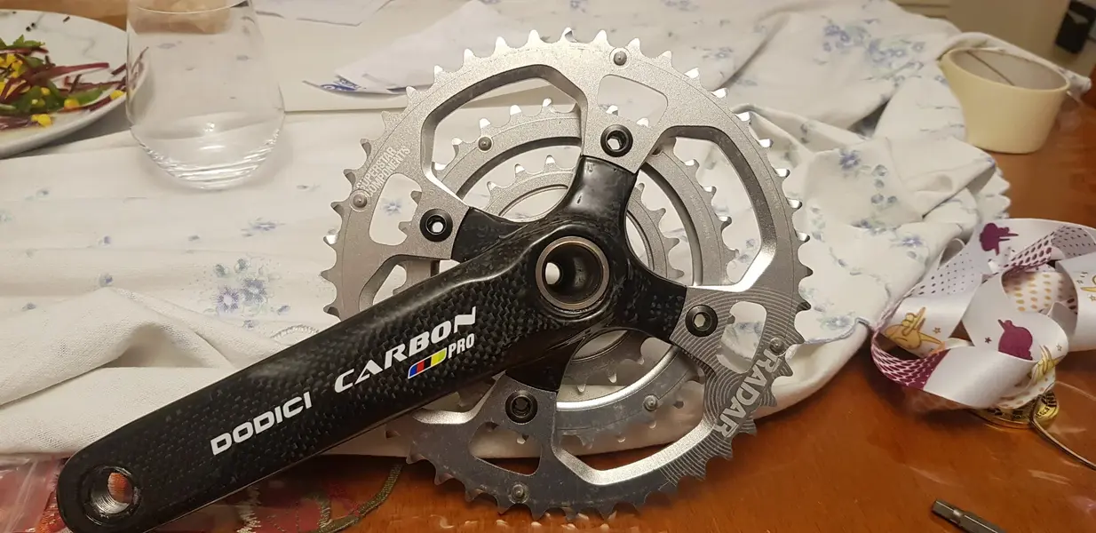

I've dry fitted the chainrings to the spider and they seem to just sit in the correct place, evenly spaced.
I paid attention to the bolts' head grooves so the bolts would sit in them (other side of the chainrings is flat, no grooves).
Also I lined up those "prongs" with the crank arm.
Is this correct?

I did think that at first but then thought that was too obvious and took spacing to mean the jump in chainring sizes. Most cranks are designed with the correct offset (between rings) so hence the confusion. But a picture is worth a thousand words so now we know…there’s no need to worry about spacing and everything looks fine as it is.

Evenly spaced is good. Tick!
Prongs in line with the crank arms?! What the hell?! Just kidding, you nailed it, all good!
No name carbon cranks imitating Ritchey logos - bzzzzt. Good luck there, you might be fine.
