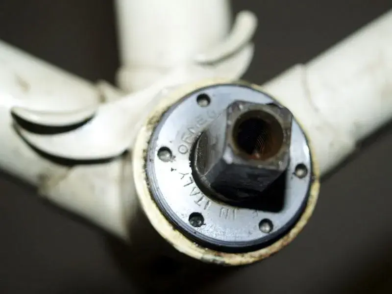

I managed to get the other crank off today but now I have the BB to contend with. :( Now its off, its really noticeable how rough the BB is.
Does anyone know which tools I need now to get this off? Before this project I thought I had a well stocked tool cupboard :lol:

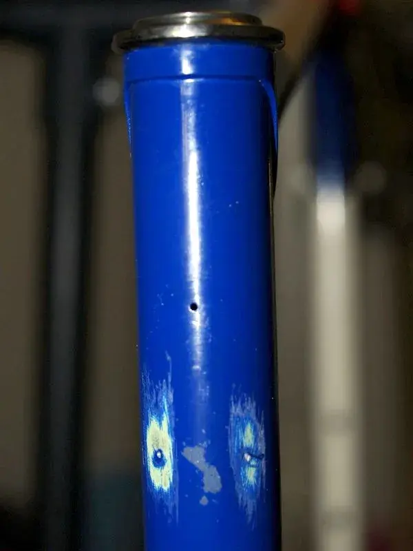

I found something interesting whilst taking the front Raleigh sticker off the head tube, three rivet holes, two of which still have half a rivet in. Would that have been standard at the time of manufacture, one at the top and two below? See pics.
Cheers,
Geoff.

.............been drilled for a Raleigh headbadge.
I take all I said back about plumping for a Carlton over a Raleigh, I'll get my coat.
