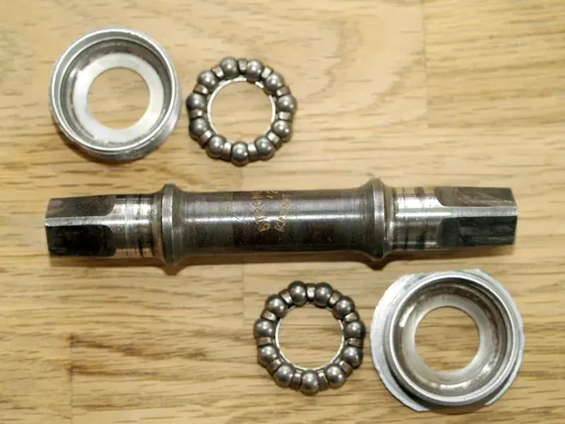

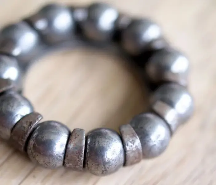

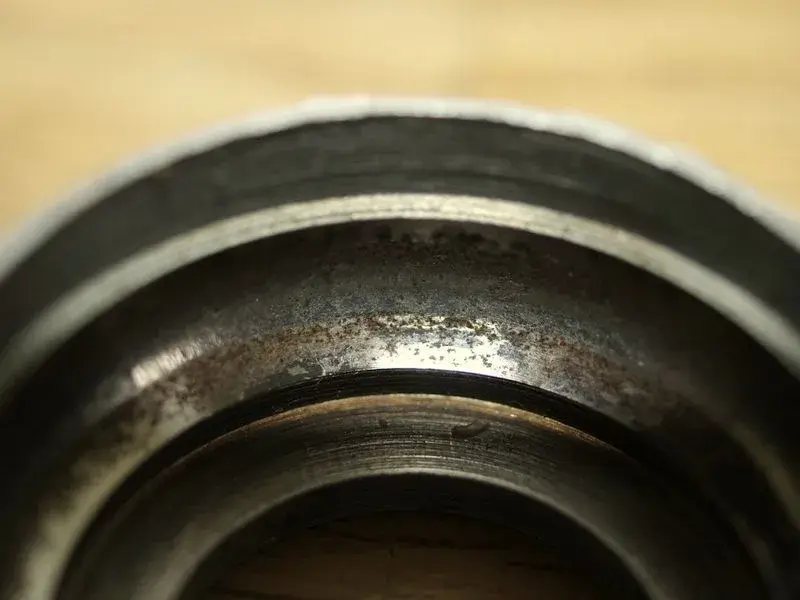

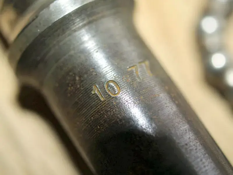

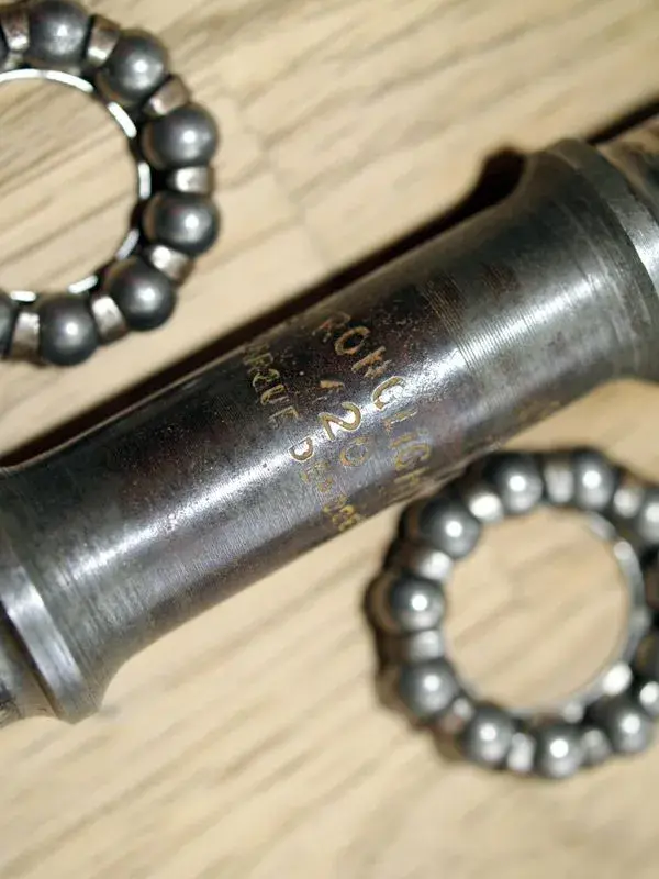

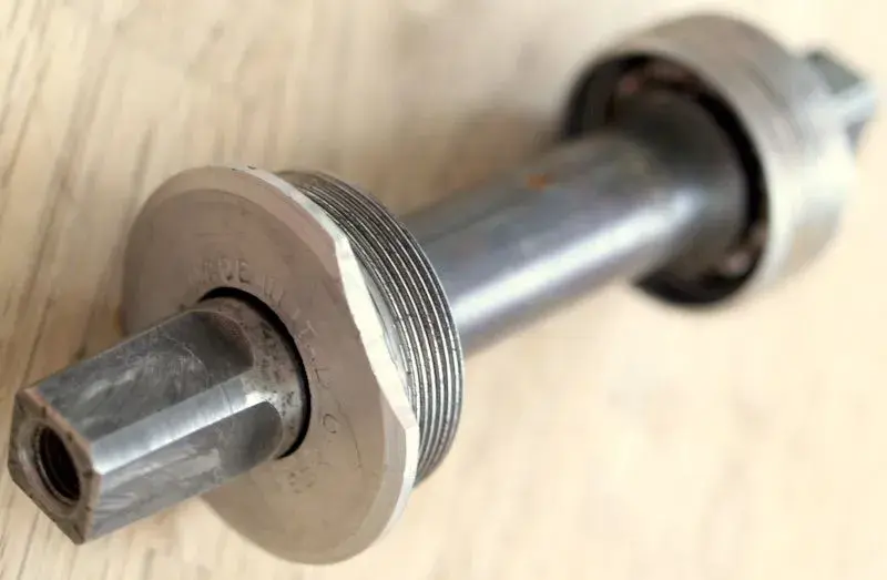

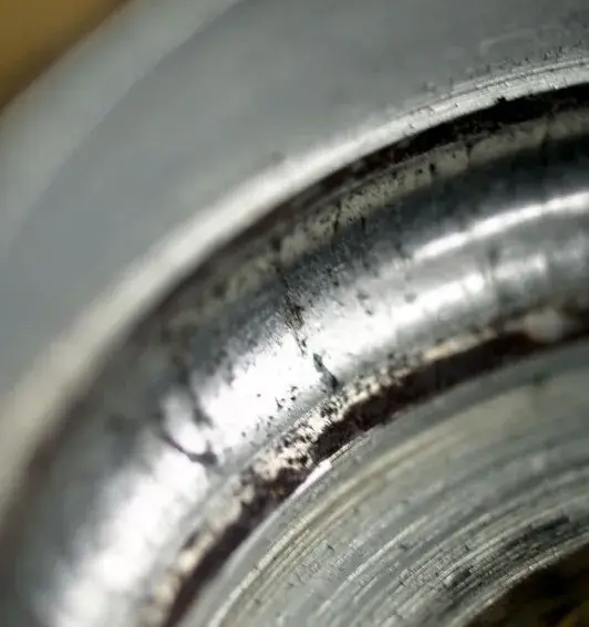

Stronglight BB too. It sounds really rough even though its totally cleaned up now. What would you guys do with it? Would you just replace the bearings with new, or replace the whole lot for a sealed BB?
Sorry for all the silly questions but this is all very new to me. :oops:
Here are some pics......

It depends on what chainset you are going to run ...........those Ofmega BB cups look like alloy with pressed in steel bearings, if so an expensive item in it's day :)
Shaun
