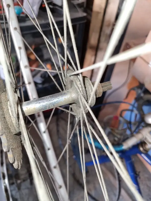

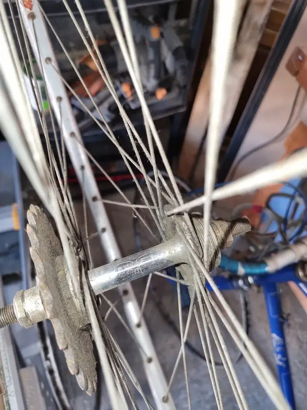

Also cleaned off the grease from the double fix hub which I attach it just has the letters FB and a picture of a bird with spread wings and a wheel below.
The hub shown is a Fratelli Brivio. They made the early Campagnolo hubs, very nice. Looks to be alloy flanges and chromed steel barrel. Again a lot of hubs of this era were like this. The pump centres are closer to the Coronation than the others. The others are 18"
Fratelli Brivio (Brivio brothers), made all sort of cycle components branded with their own and other company names. They also manufactured the original Campagnolo quick releases - and most likely did most of the development work. At one time they shared a factory in France with Campagnolo.
