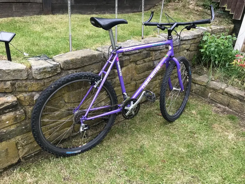

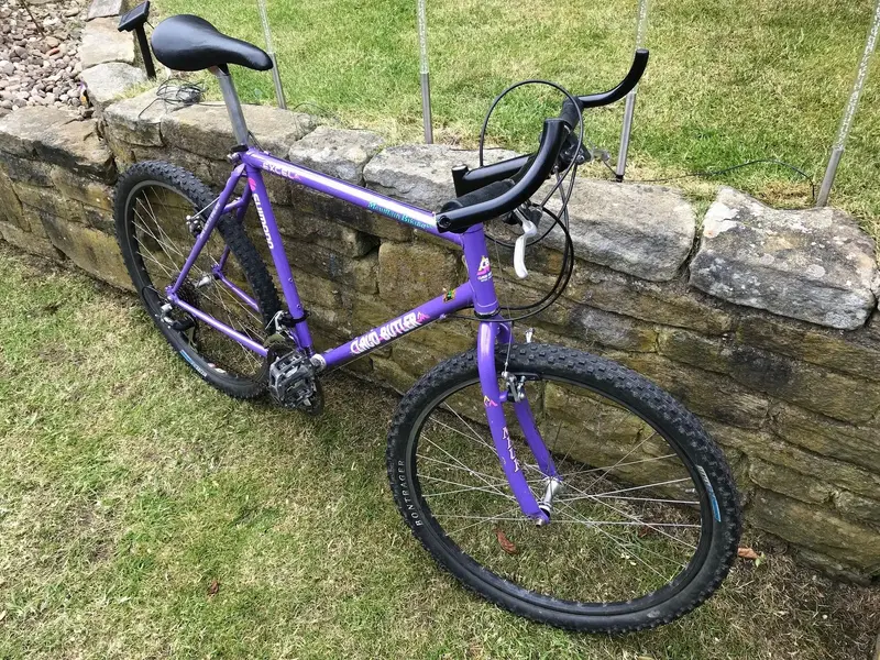

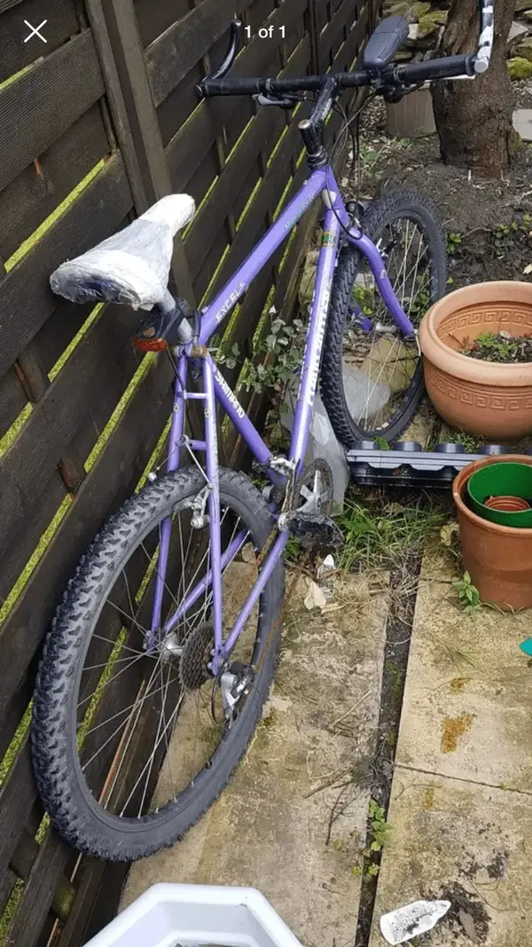

Picked this up a couple of years ago and it has been sat in bits getting in the way until now! Was in a pretty rough state when I got it and it seems to have had a hard if somewhat lowish mileage life.
It has been given a sympathetic (on the cheap) resto with a view to making it roadworthy. In doing so it has been kept pretty much original with a new BB and a replacement A20 front mech as the original was bent. Bars, stem and bar ends were rusty and so were rubbed down and given a coat of satin black, the seat was re-covered as the original was knackered and everything else was given a clean and fettle.

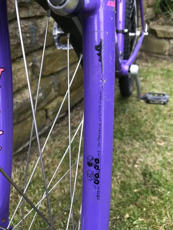

Not seen an Excel like this (in this colour), reckon it's 1993 due to the Altus A20 groupset. Oh, and it's got a Mint Sauce sticker on it which makes it instantly cool.
Frame: Reynolds 501 Magnum
Fork: Original, rigid, unknown material
Headset: Tioga
Stem: Claud butler branded crmo
Handlebar: Claud Butler branded steel of some description
Grips: Claud Butler
Barends: Unknown brand, assume original to the bike?
Brakes: Altus A20
Brake Pads: Jagwire
Brake Cables: Cheapo replacement front, original rear
Cantilever cable hangers: Shimano
Brake Levers: Altus A20
Shifters:
Front Derailleur: Altus A20
Rear Derailleur: Altus A20
Derailleur Cables: Cheapo front, original rear
Cassette: Original Shimano
Chain: Used KMC
Cranks: Altus A20
Crank Bolts: Original Shimano
Chainrings: Altus A20 (riveted)
Chainring bolts: N/A
Bottom Bracket: Neco
Pedals: Welgo
Hub Skewers: Original Shimano
Rims: Rigida Laser
Hubs: Shimano Exage
Nipples: Brass
Spokes: Stainless
Tyres: Bontrager Jack Jones
Tubes: Unbranded
Saddle: Original Vetta Gel (re-covered)
Seatpost: Kalloy
Seatpost Binder: Kalloy
Weight: Reassuringly solid
As bought:
Now:

What a transformation, top work!

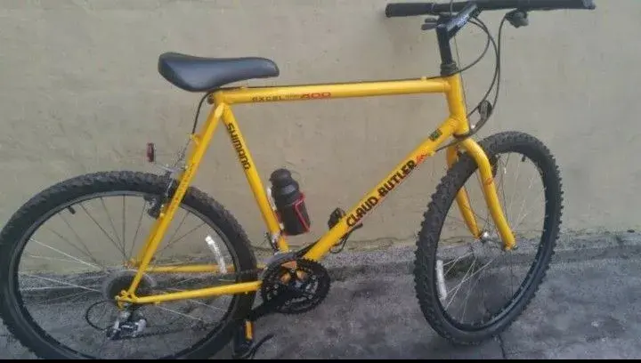

Looks like Jimo746 spotted an almost immaculate one on Gumtree last year…went for £39!!!
viewtopic.php?f=4&t=394639
just smacking the the brain cells with some black sheep ale....were these not just an empire catalogue renamed version?
Re: Re:
I think you might have something there.....
Peachy!":kykonvhs said:
Just had a quick google ‘cause I was bored… :facepalm:
Yeah I actually bought that one. I couldn't find any info in the CB Catalogues for it either.
You might be onto something about it being a "Catalogue-Claud" :lol:
