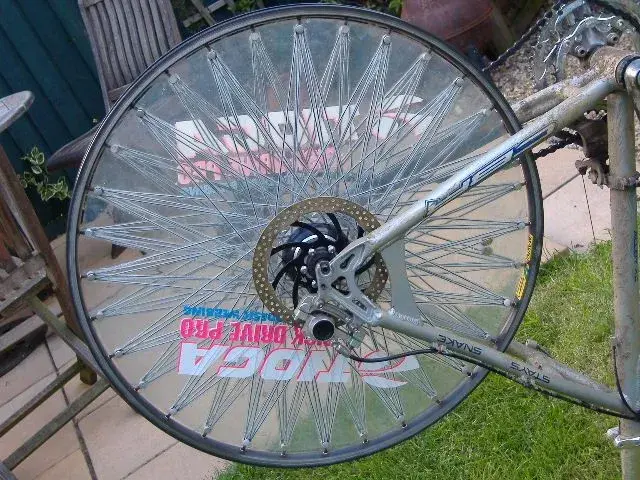

Clear Tioga Disc Drive Pro & Disc brake compatible
hi mate i ran a disc brake on mine no problem at all 8)

Thank you for the information! That is my model, now I have te doubt of keeping it with v's or passing to avid bb7's...
May I ask what hub are you using? I wonder if I can as well use 10 speed.
Thinking about it. It was a SRAM X9 hub with lock on hub adaptor. Dead easy to set up as normal. Also ran it as 9 speed as well no problem so 10 speed should be ok. Maybe a centre lock disc hub will be ok with some mods to the disc centre lock back plate by just reducing the radius of that part to fit the disc drive over the hub So it bolts together to the hub
