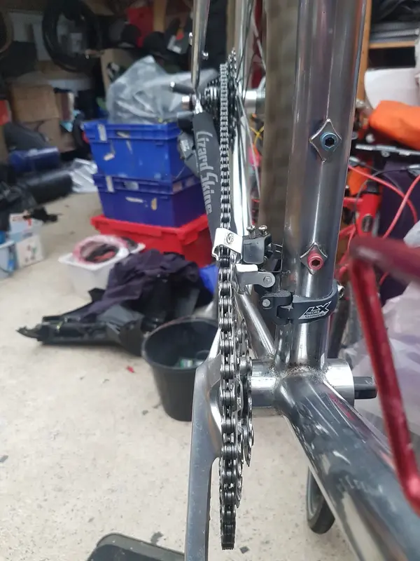

Pictures are now required.
Not of janice,of the front mech and its alignment.

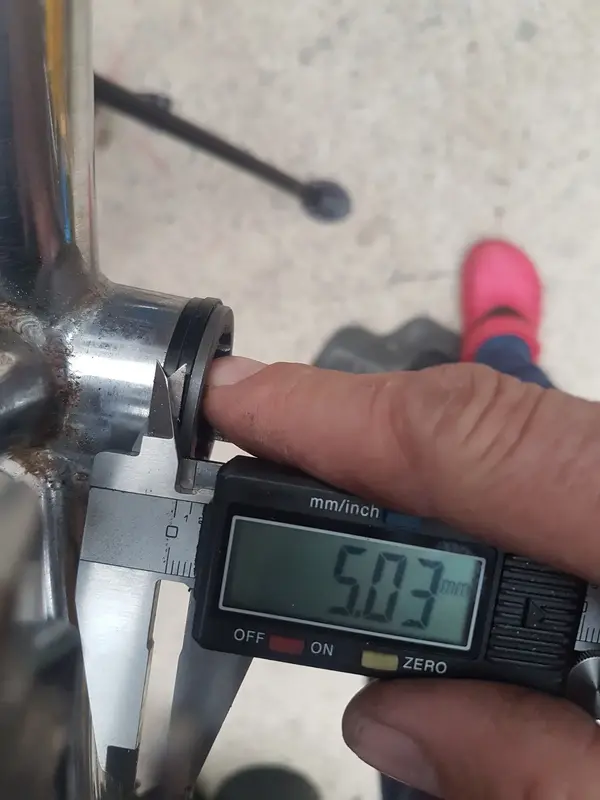

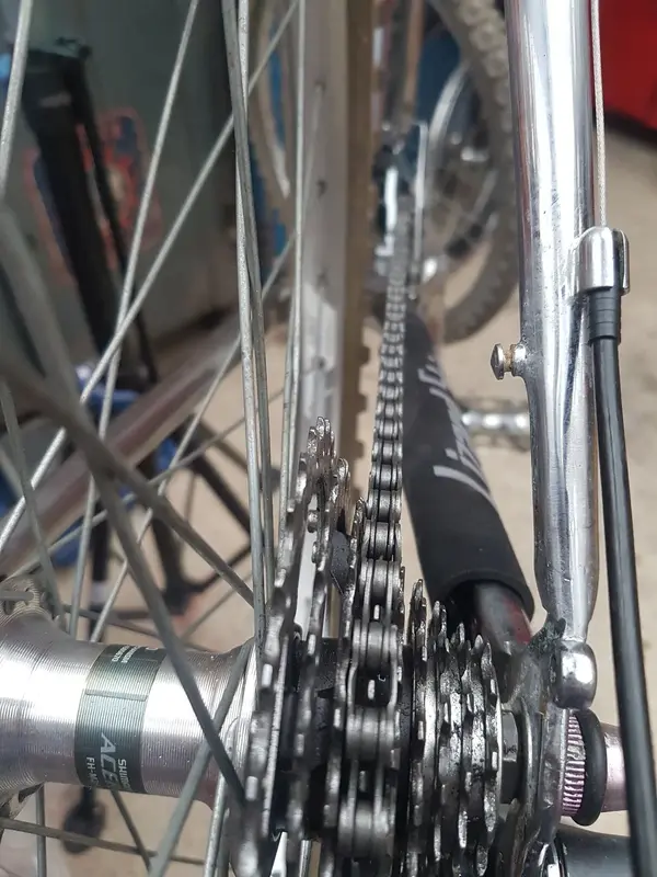

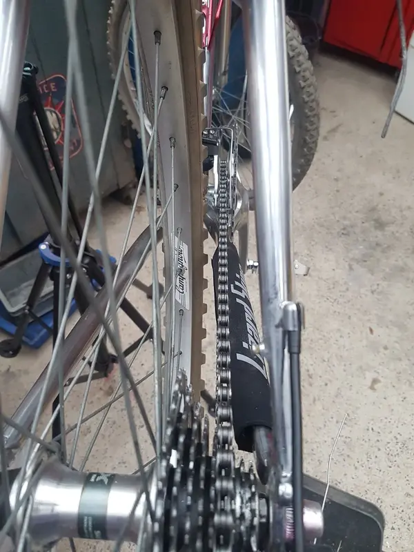

The chain line will need to be sorted (around 50mm) with a correct BB, and then check your cable routing at the pinch bolt.
Thanks for all the advice. I have had minimal experience of mega 9 and all of it makes me think it doesn't play well with others as shown in some random pictures using the MT60 crank the drive line looked fine. The chainring gap is as close between cranks as possible yet when i just reset the BB with no spacers (113mm) then used the mega 9 crank, all gears available and smooth i just needed to tweak the front mech in the centre as i had a bit of rub in the extreme gears.
