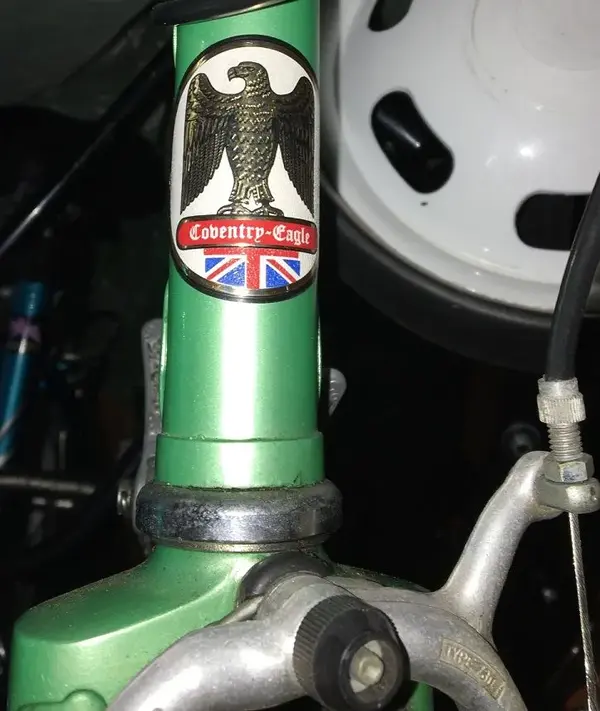

Hi all,
I'm looking to see what I can do with my much loved Coventry Eagle which I got in 1986 as a special birthday present!
Lovely bike at the time and was probably in the £350-400 range.
Reynolds 531 tubing.
Simplex SX 410 rear derailleur, 10 speed gears. Downtube shifters. Front derailleur broke, it was Simplex plastic bolt on. Now got a nice shiny new black Shimano.
Weinmann side pull brakes.
Sakae Custom 170 Crank/BB.
Steel/Chrome 27" x 1 1/4" wheels with 36 spokes.
Came with mudguards and was very much more of a commuter/light tourer.
Looking to keep it as original as possible but always was a bit cautious of the steel rims and braking. Got used to it when younger but being that bit older and slightly heavier :shock: , I'd maybe like to get better brakes.
LBS who fitted the new derailleur suggested I should ride it as and if I wanted to keep riding it a lot, I could take the next step and upgrade the wheels to 700c.
That would mean longer reach brakes.
What else worth doing if anything?
I could do it as an ongoing project bit at a time but happy just getting alloy wheels and better brakes just now. The 700c would mean I could get tyres a lot easier from anywhere.
One question, at the back of the rear dropouts there's a tiny screw thread. What's that for?
I'll attach pics.
Many thanks.

The threaded hole on the back of the drop outs is for a screw and spring which is used to centre the axle in the dropouts and makes it easier to refit the wheel in exactly the same place each time, here's one of mine...
