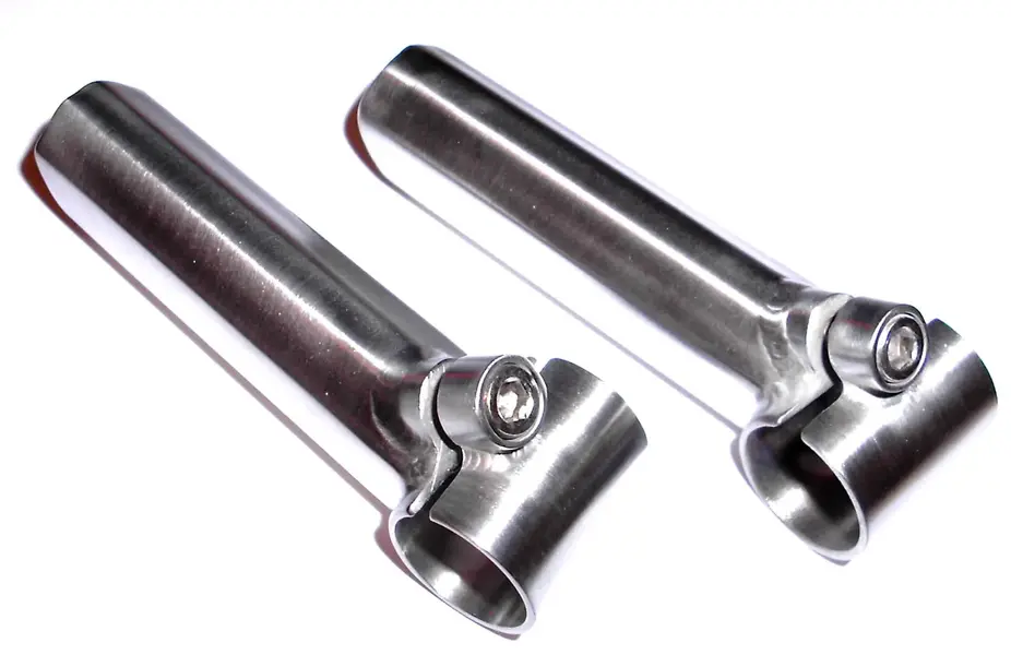

on the crimping subject it depends which barends you use.
most Ti barends use a very wide clamp to prevent crimping your Ti bar.
You can see the bar thickness here :
The clamps are about twice as wide as the old onza aly bar ends I had. I have some kolo Ti bar ends and they have a similar 'wide' clamp :D
WD :D
I'd still bung some BERTs in though.
