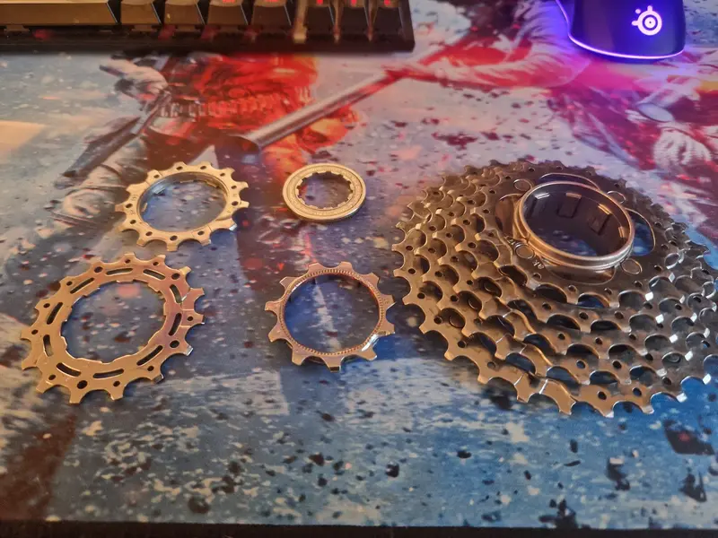

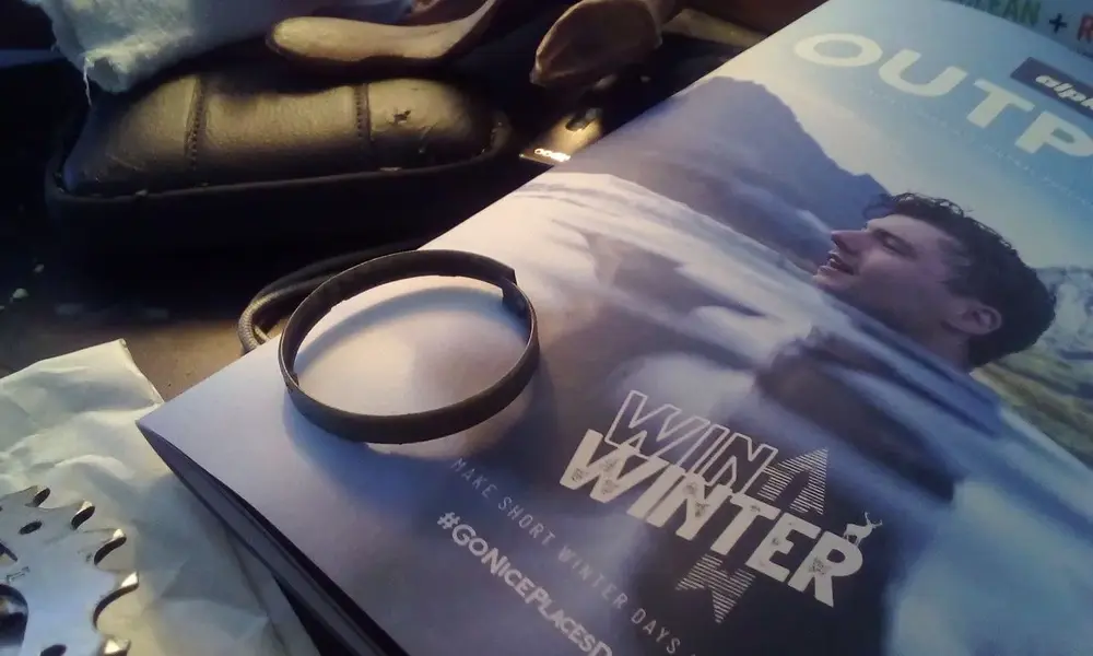

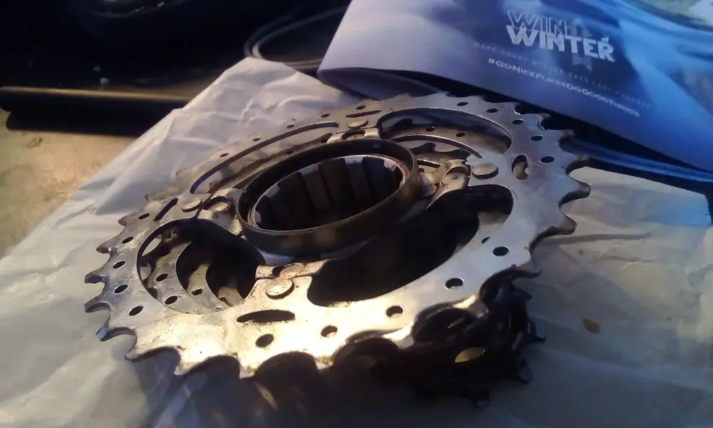

Yeah i own two 737 cassettes one pictured here has a intigrated spacer ...
My other cassette it was missing and i had to pop a couple of spacers on freehub ...
I will measure the spacer later ..

You'll need the spacer, mainly as you're fitting a Compact Drive cassette to a standard freehub on the 900.
It cannot cope with the 11T so needs a thin spacer, often the one fitted as shown in these later IG styled cassettes (M737-I), earlier you just had to find something.
If you do manage to clamp it down without one you may find the freehub crack near the threads... <whistles> but to be fair that freehub still work nicely, since way back in 1993/4 I tried....
