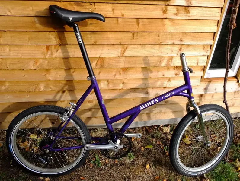

Swapped the saddle with a WTB one that came on my Saracen Trekker. It's too modern for the Saracen but looks good on this I think. It's pretty light, and hopefully reasonably comfy.
I'm not going to use the LX mech pictured after all because the combination of long cage and small wheels has the potential for ground clearance issues. I picked up a short cage XT one off here... want to clean it up and see if I can find a replacement for the worn jockey wheel before I fit it.

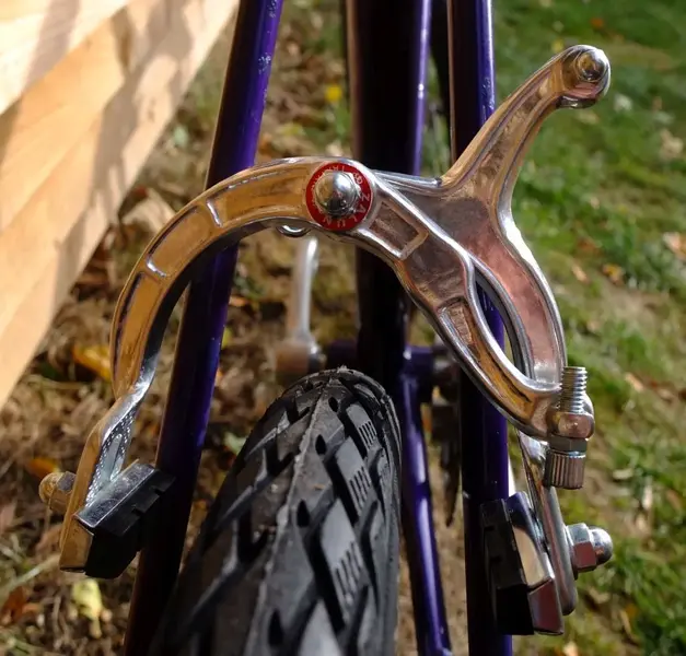

Found a brake caliper for the back. This has actually got way more reach than I needed... It's branded "ZALUN, Taiwan" but it came as part of an Oxford MX brakeset. They're still readily available e.g. http://www.alansbmx.com/1353581/product ... e_set.aspx - the little levers can be handy too.
The best thing about it is that I was able to swap the pinch bolt and barrel adjuster around so I can route the cable from below. This can be a bit of an issue when upgrading step-through / ladies bikes...

Thanks man!
Wheels are off a kids bike I think and were picked up very cheaply off eBay. Alex rims and low end steel hubs - which seems to be par for the course with kids bikes. They spin smoothly enough though, (new grease in the rear hub, and just adjusted the front) have hardly been used, and will do for the time being. At least the alloy rims will give decent braking compared to the chromed steel originals.
If I love the way the thing rides I might build some better wheels up at a later date on some old DX hubs I have.
