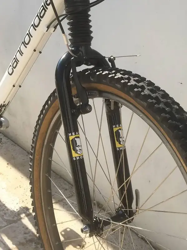

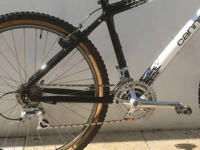

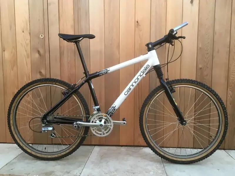

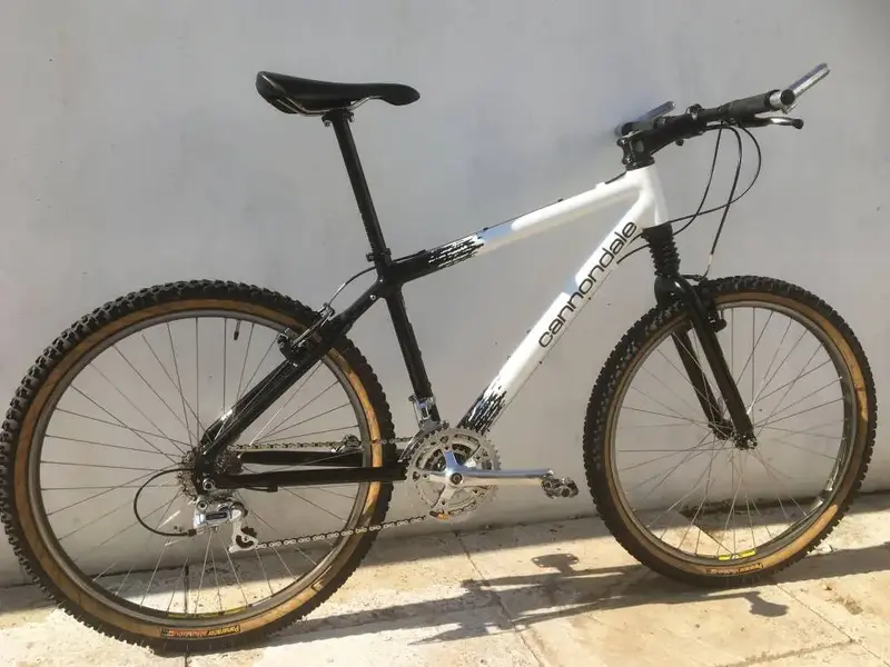

You've seen it already, but my Cannondale F400 was powdercoated in white. The forks in gloss black. The rear was then a gloss black wet -coat over this.
The whole thing was then scuffed over with a scotch brite pad before the ripped dividers and graphics were added. Interestingly, it's a combination of suppliers for the decals.
Ripped dividers = Gil_M
Cannondale headtube and downtube = global-cycle-decals
Headshok decals = bicyclestickersuk
The frame and forks were then clear coated using a wet automotive lacquer. I'll confirm with the guy that painted for me, but the modern paints we use are all water based.
I think the main difference is that this was left overnight in ambient temperature controlled spray booth to dry/ harden. I'm pretty sure this temp is no higher than 50deg C. The Rapid prototype parts we paint distort if the heat is too high and my frame would have been put in with them. Does the thickness of the decals make a difference? - these ebay ones were almost like a screen print rather than a vinyl cut.
Here's some pics.
