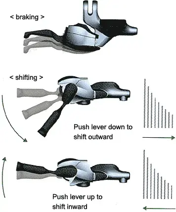

Yes Rapid rise works perfectly with these levers
When you have these levers you find out that all front mechs are like Rapid rise as when you lift the lever the front moves down towards the granny ring
so if you have a rapid rise rear mech it works the same, so lifting the lever moves the chain up the rear cassette
so its press down on the levers for going faster or lift the levers when you hit a hill.
I have rapid rise mechs on all my bikes with dual control
