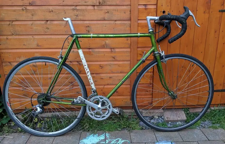

I was pleasantly surprised when a gumtree search popped up with a local advert for a random job lot of low-end components still attached to a mangled Scottie frameset. The previous owner had the bike damaged while it was parked in a street. Took it to a bike shop techie who told him that the frame is beyond repair. The frameset was in my size and fitted very well into my criteria of a bike in need of some work & a bike without the period-correct components. Bingo! Thank God I'm not a bike-shop-trained mechanic, because I think this is repairable. At least I will try my best to get this beauty on the road again.
The seller was happy to give me the frameset for free if I was paying for the components, so the purchase was a no-brainer. He made me a very happy retro-wrencher, at least until I find out that the frameset's a gonner 😭 .
"Take it to the tip" I hear you say. Well, not a scottie. Droch Stàilinn's here to stay.

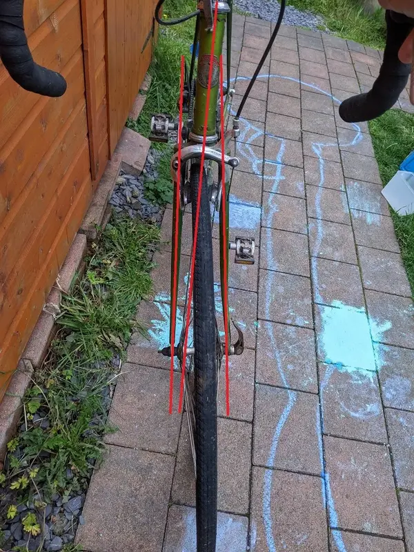

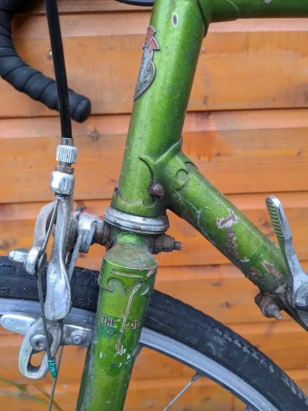

Obvious damage to the frameset:
- Forks bent out of shape.

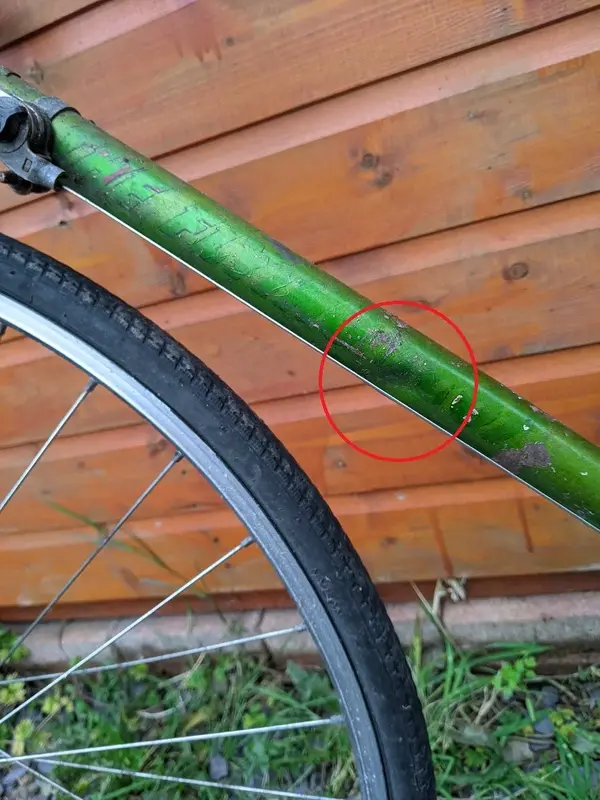

- Deep dent on the downtube
- Moderate rust
- Rear triangle lightly out of true
- Frozen seatpost
- There's more to come on closer inspection.
This will likely become a long-term project in particular sorting out a gauge to true the forks & truing up the frame, but I'm in no hurry.
Beam me up, fellas!

It'd be prudent to check the frame I reckon...
That dent....more pics ....all angles! I've managed to get dents out using homemade split clamps and using paper shims...

Most importantly - forks.
I've had a wee nosey with a straight edge and I'm pretty certain that the bend is in the crown. I cannot spot any significant damage in the blades.
What I'd like to know, is how much bending the crown can take. I.e. If I manage to set it back without cracks, are there any risks that the crown may fail in future (Why and how?). Hopefully some experienced members here, or at least some metallurgical knowledge of why a twice-bent crown may be more likely to fail than a virgin one.

Dent can probably be left alone and the bike will still be ridable, but I want to sort it out. Will take some more pics later.
I've seen @Nabeaquam use a rod brazed to the frame to pull out a dent. How much force does that take?
What about automotive dent pullers? [No idea how they work]
As an alternative, I was thinking of drilling a very small hole in the dent, then from the inside, feeding a piano wire or a brake cable through it, with a copper plate shaped like the tube attached to it. I can pull the wire to get the plate to push the dent out from the inside. Then probably braze the hole shut. Just an idea.
