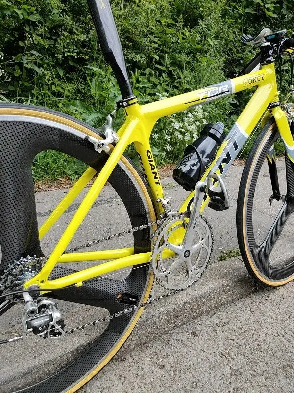

Taken a lot longer than I had planned but finally finished the Ex Team Once TCR Time Trial Bike I picked up some time ago.

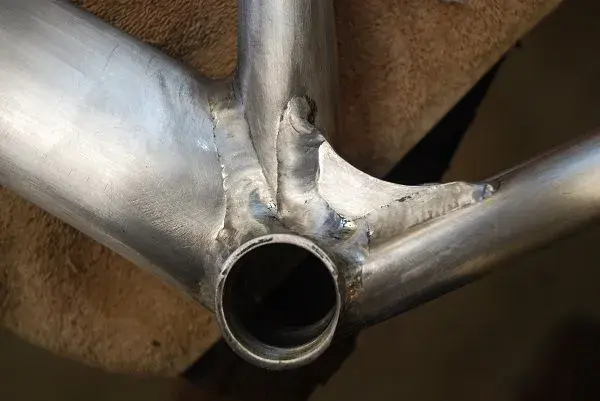

The bike was missing groupset and wheels but the best was there - although it had been repainted in Liberty Seguros colours (Once became Liberty Seguros in 2004 - they issued BH road bikes but re-used their Giant TCR`s as TT bikeds - same TCR`s but with TT bars and saddles. This one still had plenty of Once stickers still on it and the classic pro thing of stickers covering up things like a Cinelli sticker over the 3ttt bar sticker. The frame also had some neat additional ally filets (guessing to add strength) welded in place around the BB and the seatpost/top tube junction and a lot of smoothing of the welds.
One painted (not doing that again - a lot of tricky masking...) it was fitted with a really good Campagnolo TT groupset and Hed Tri spokes with Veloflex Criterium rubber.
Put it on the turbo for a few sessions to tweak the fit and get used to it (first time on a TT rig and it definatly streches you out) then took it out at the weekend for its first real ride - its certainly fast but man its a stiff and challenging ride on the cr*ppy roads where I live (planning on re-locating it to the slick roads of southern France soon).

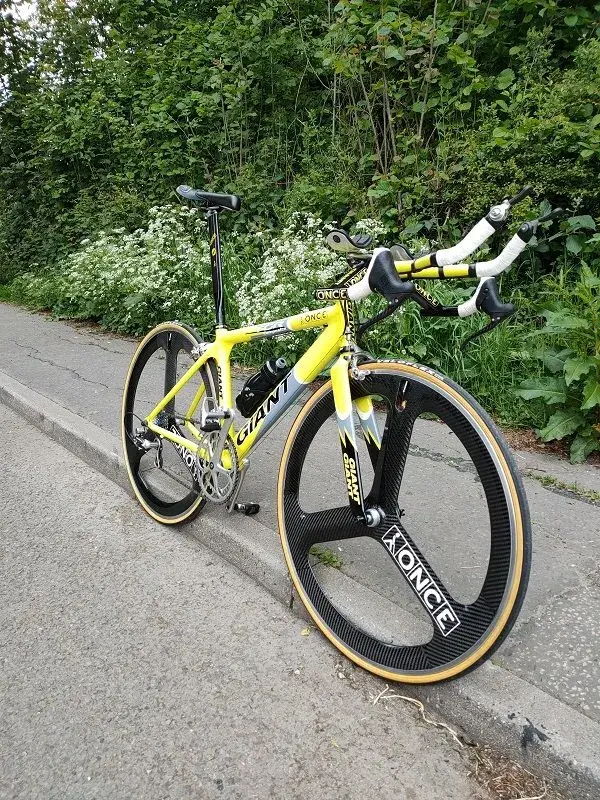

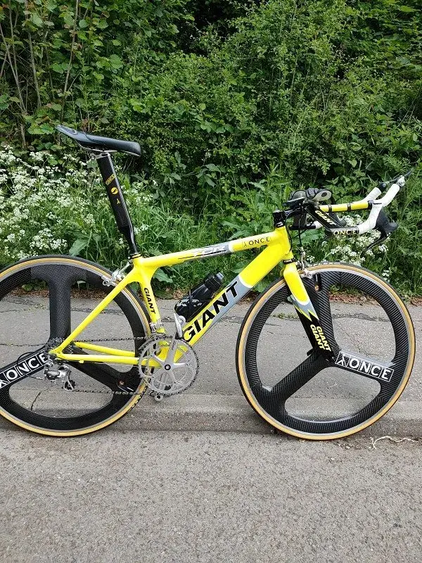

Finished bike (don`t worry about the seat angle, has been adjusted):

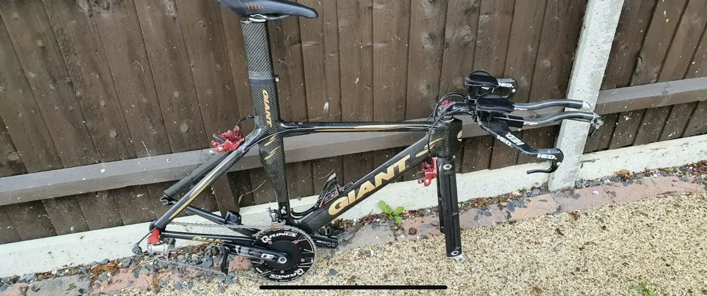

As it was when it arrived:

Additional ally re-enforcing filets:
BB filets:
Finished:
Super Record 10 speed TT groupset 53/42 11/25:

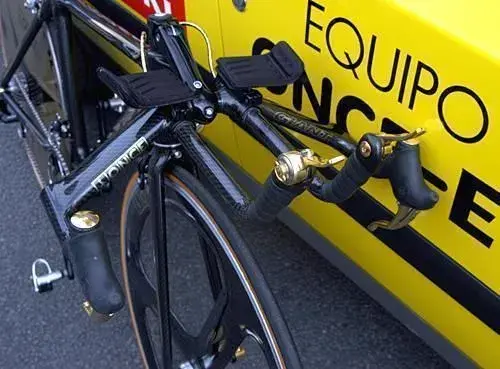

Outstanding restoration. Odd that Manolo Sainz at ONCE didn’t rebrand the composite Giant TT frames ONCE used in 2003 (and maybe 2002)?

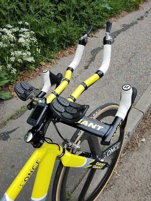

Hi Dan, who makes the adjustable stem in your ONCE TT bike restoration? Is that a Giant stem? An evolution of the original EXT Mike Burrows ones for the TCR, but for a-heads? I need to source a few and I’ve had no luck searching eBay as yet.
Yep, its very similar to the Mike Burrows one, the three piece one thats basically a collar for the steerer tube then the two sides that bolt together to allow full range of adjustment, these are bolted to a 3TTT tribar setup with Cinelli stickers over the 3TTT ones.
Loads of unanswered questions about these TCR`s - by the time ONCE became Liberty they were on carbon TCR`s, I guess that however road this one really liked the re-inforced ally version and stuck with it, Dan.
Thanks for your answer Dan. Much appreciated. I’m just starting out on a bunch of ONCE restorations.
