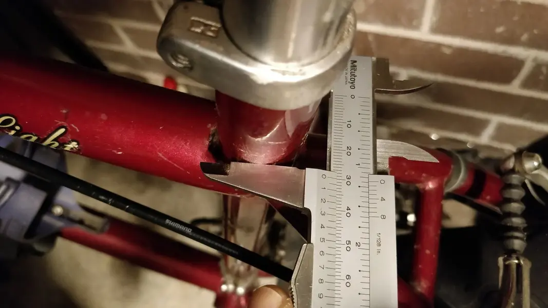

Seat clamp diameter is 30.0mm. The rest of the tube is 28.6mm until it ovalises.
