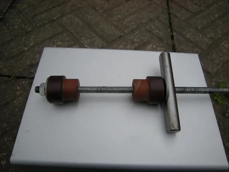

I've made my own headset press shown below, it has avothane (or urethane) inserts which keep everything in line and square. You could use nylon, rubber or whatever else but I suppose not everybody has access to a lathe.
