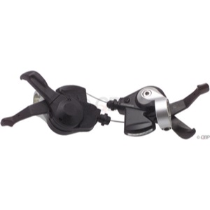

Found this STX RC front shifter
I have these on my modern Marin (8 speed) shift well, no hassles, look nice.
But I have managed to crack the top cover of the left one overtightning, so if you want to get rid of this really cheap let me know.

Try and get ones that dont work, the ratchet gets gummed up and is piss easy to get working again.
is it literally just strip, clean, re-grease and rebuild? I've had loads of these fail on me (misfiring) but sometimes the bottom push lever gets very wobbly - help!
If I remember correctly, to tighten 'wobbly' bottom lever, theres a reverse thread nut under the plastic cover.
The ratchet gets gummed up and needs to be soaking a light oil to free it, then 3in1 for use.
