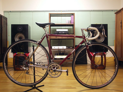

So... I have a 12spd and would like to go faster, what's my best option? I was thinking a new freewheel with a smaller small cog though can't seem to find nowt smaller than the 14 that I'm already pushing, do such things exist or should I be looking at a biggerer front?
If I was to go down the new rear route can I chuck a 7 cogger on or am I limited to the 6?
Loads of Q's have a pic as thanks.
Sadly not my bike

If the rear spacing is 126mm then you should be able to put a 7-speed on. You can buy new ones but they tend to be cheap and nasty. Plenty of new old stock on ebay, many with 13 sprockets. You won't be able to find them with the kind of range we're used to these days. Lots of 13-19 racing blocks around, which don't suit me.

Thanks peoples, some great info there. My comute to work always starts with a stonking big down hill which I guess is why I felt the need for taller gearing. Happy with the ratios on the 12 spd other than that so if I have the space to squeeze a 7 block with a 13 I may do that.
Think the front is 52/42 but would need to check to be sure. Come to think of it I don't know how long the cranks are either.

It is a 52 14 and 170 crank with slightly ropey bb, guess my penny's are better placed elsewhere on this new cycle.

On the comments about crank length, looking at your frame (50cm size?) if you have short legs you would definitely want 170mm IMHO.
