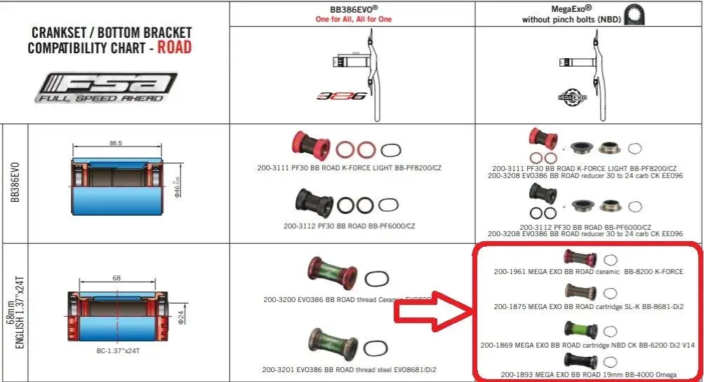

Many hours consulting previous posts on numerous forums and contacting FSA directly reveal that:
1 - A common theme is the 'mystery' of FSA BB/Crank compatibility.
2 - FSA continue the mysterious theme with numerous, contradictory 'compatibility charts' - none of which inspire confidence.
3 - It is generally considered (and i concur) that the copper? coloured BB's are a prime example of a manufacturer not consulting consumers with regard to what constitutes 'tasteful'. In fact, it has been suggested that if FSA had bothered to ask which colour NOT to manufacture a BB in - natural selection/wisdom of the masses (call it what you will) would have rendered 'that' colour (i can't even bring myself to try and describe it) as the one to avoid.
Anyway.....the net result of all this scratching about is that the chart shown (whilst offering no guarantees) is about as close as FSA can get to producing something at least reasonably close to the truth.....in as much as there are several BB options for SLK cranks (but only SPECIFIC SLK cranks).
What a gurgling bloody mess - that's all i can say.

if I get change I'll pull the crank tonight/tomorrow and see if there is anything internal. but from a look at your chart 200-1875 matches what I have the best.

if you have a 24mm both ends of the axle, then you should be able to use a normal 68mm shell shimano road BB, i have seen this done a lot but not all FSA chainsets can do this, but they are quite a bit cheaper than the original FSA unit, bearing in mind i assume you will be refitting the other cranks after this event. if however the axle is 24/22mm which i think some FSA cranks were then you need a specific BB for that from FSA, i should point out though that even if you use a shimano bb if the FSA chainset has a spring washer you should still use that as the unlike shimano cranks with a preload cap the FSA cranks i think do up to a fixed point and the spring washer provides the bearing pressure.
i would point out from experience that the FSA bb's do not seem to last as well as the shimano ones so if you can fit shimano i would.
I have a similar issue with an older SLK carbon MTB crank. All info on the net was related to the BB30 version of the same named crank and not the 24mm version. The spindle didn't fit well into a shimano BB because there were two rasied bearing interface sections which we 24.1mm and that 0.1mm made a difference. I did use the Shimano BB for a while but had to play around with a few wave washers to get the right preload.

Thanks Synchronicity - that's a good find - that BB will work with my cranks.
