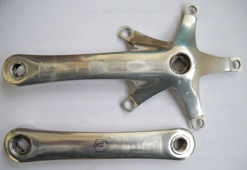

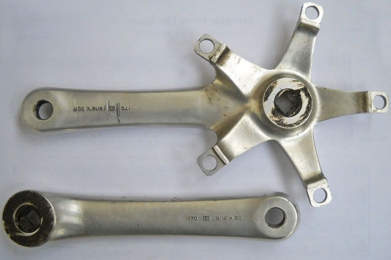

Got the cranks out today. Were really stuck too but here they are ready for a clean and polish.

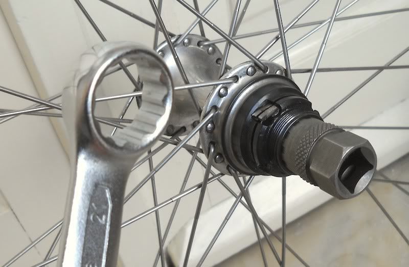

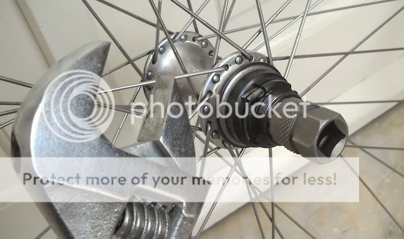

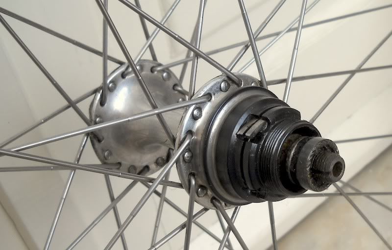

The freewheel was still stuck even after days with w40.
Been using this wrench but holding the wheel, holding the wrench so that it won't open or slide and putting my weight on it is complicated. There aren't enough hands. The handle would dig into my palm and still nothing. The freewheel won't move.
Got a box wrench. It holds it self and grabs the freewheel key much better.
Stroke it twice with a rubber mallet and the freewheel is out!
The best way I found to remove a stuck freewheel is to put the tool in a vice and turn the wheel with two hands. Lock the tool into place with an old skewer.

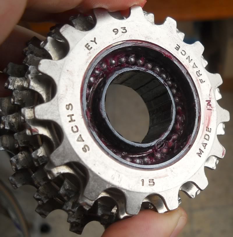

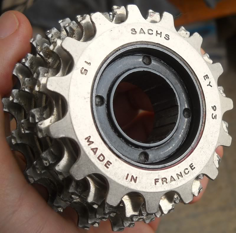

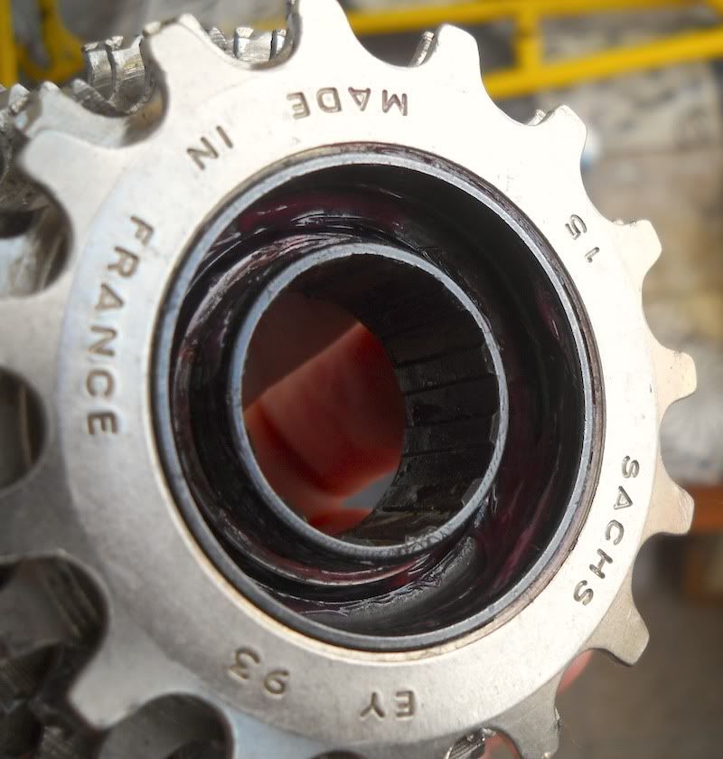

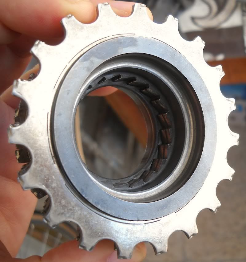

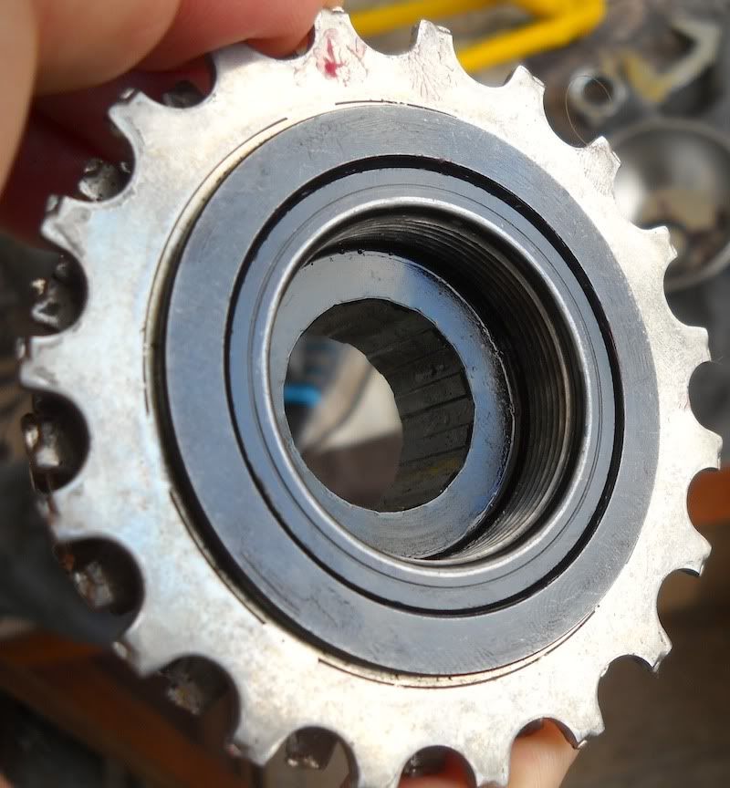

With the freewheel out I finally could re-grease and reassemble. Here's the clean cog body.

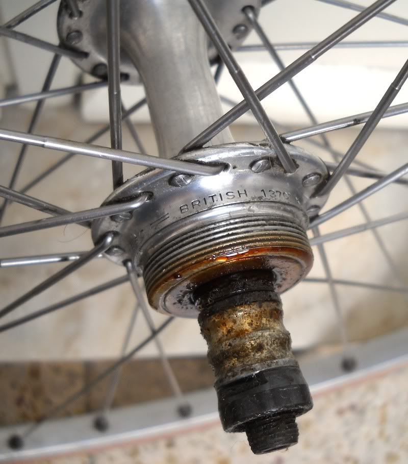

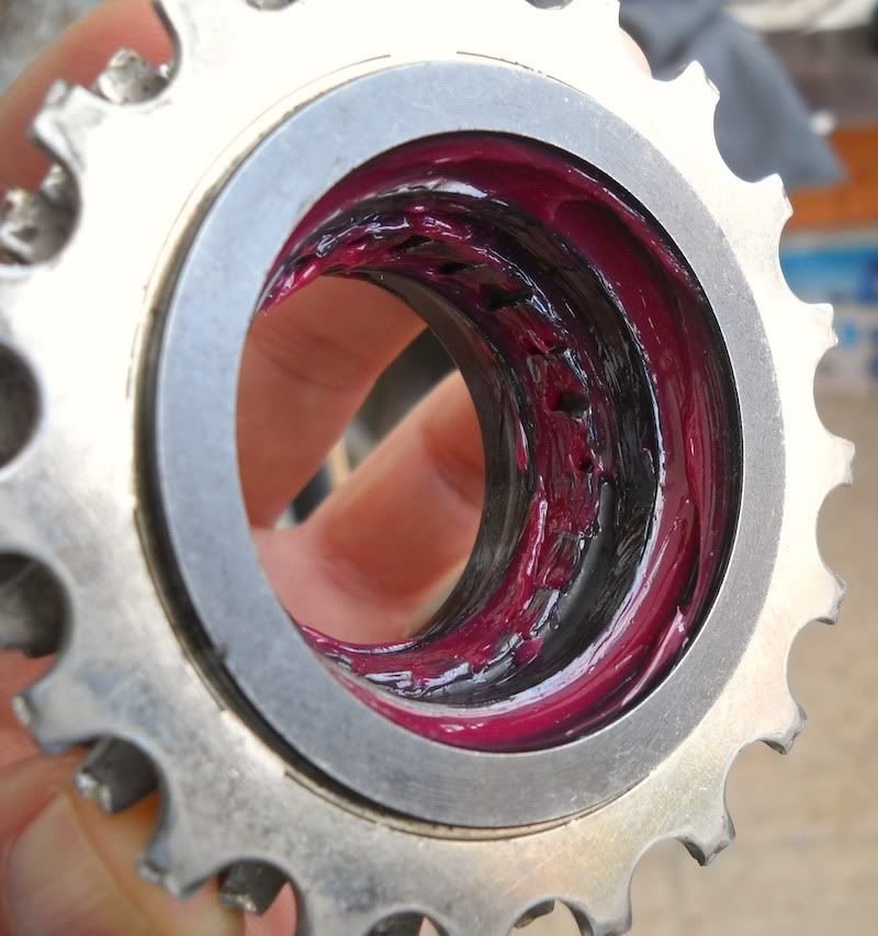

Apply some grease:
Put the bearings in. The grease helps as the bearing stick to it and don't fall off.
Insert the hub screwing body.

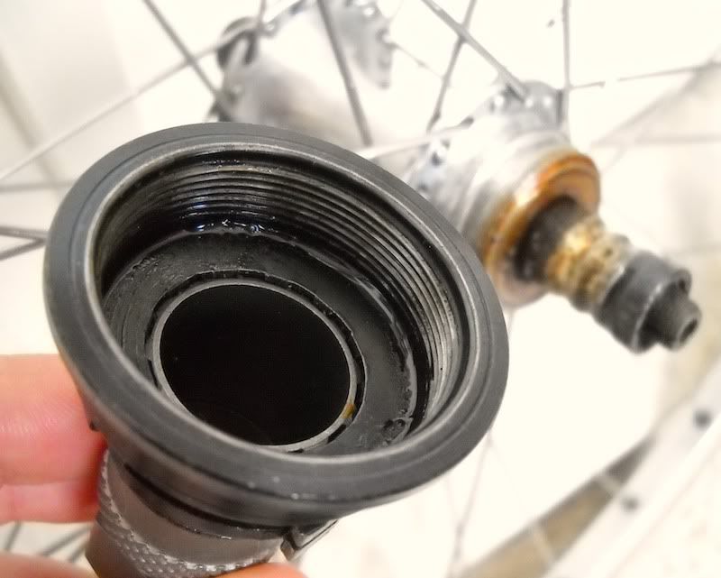

Turn upside down and apply grease to the other race.
and close.
Ready and working. 8)
