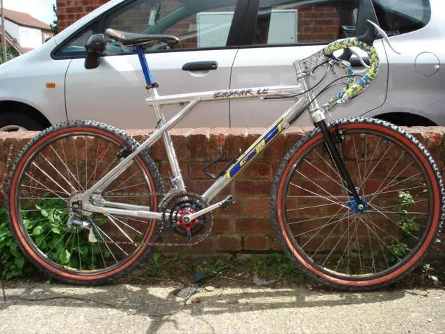

Now I'm an old (sorry, retro) giffer, my back and wrists are unwilling to put up with the traditional arse-in-the-air, MTB stretch that a long toptube and 140mm stem dictates. (A man needs to know his limitations ....)
So,
Issues:
1. I like curvy bars: good control, hand positions, sweet left-field looks.
2. Getting said bars on and off various stems to tailor riding position is a nightmare: just trashed the anodising on a set of one one mary's.
3. I'm seriously considering a lightweight clamp-style aheadstem with a 1" quill adapter.
4. I know little about the world of aheadstems: it's always been quill; so it's difficult to narrow the search.

Reckon you can still get a face off quill stem maybe a profile boa or a syncros hinged if you hunt around. Otherwise if you go the adapter route syncros or control techs offer plenty options and are reliable, plentiful and reasonable.
Quill/Ahead adaptors tend to be pretty weighty afairs, thereby negating the benefits of Ahead. There are a few nice quill stems with face plates (As Kaiser said - I like the Salsa) or you could always go with the time-honoured '2p-piece-in-the-slot' and reverse the bolt to open the bar clamp up a little! :wink:

I'm using an adapter with an ahead stem on a 1" threaded for steerer.
Has done my back (which I have problems with) the world of good and I'm defiately enjoying riding more for it.
I just bought a modern Kooka stem with matt black bars from LBS as I was in a hurry (and hadn't found this place at that point!).. made by Kooka I think.
I've ridden off road and noticed no problems from using the adapter and that was with a fully rigid bike so plenty of hard landings :D
Oh yes; there she blows. Haven't found a uk importer so I'll brace myself for customs and look up a 25.4 to 26mm shim [i think hubjub do a nice one]; neater and more fitting than the adapter route methinks.
Thanks for the steer [!] fellas. :wink: :D
