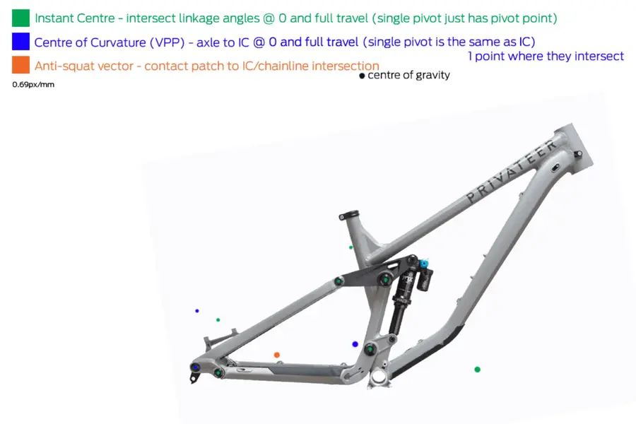

I have in the past worked out where the VPP is for other reasons, this pic shows how.Nice to get into your thoughts and various travails of getting the tension right. I did wonder, since some eccentricity woudl I assume help with the smaller loop…
With a head full of virus…and brain working like a clunker…I indeed had thoughts of ‘how do you find the pivot point in a virtual pivot context?’ - I should immediately have realised that on single pivots, and with helpfully higher pivots away from inference with chainrings, the pivot point is er…stunningly obvious.…apologies
