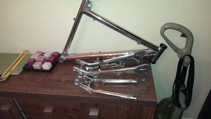

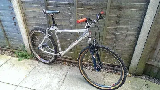

I've done a mock up, mostly because I was excited and wanted to see what it's going to look like.

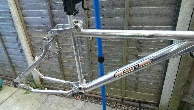

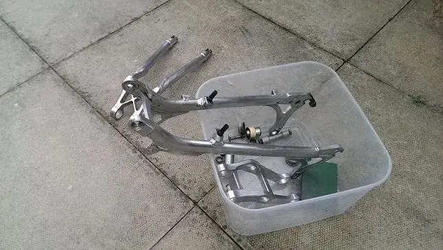

I've now got the thing apart and started the polishing. I've used fine wet and dry on the really pitted sections and t-cut on the rest. I know there are probably better options out there for this task but that would involve going outside and buying things.

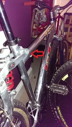

I arrived home from holiday to bushings, decals and a shock so rather than unpack I started fitting bushings. This was pretty easy, the only problem I've encountered was that the pivot on the top tube (pictured with arrow) still has some play. I can live with it unless anyone has some tips? It seems that the play is between the bushings and the pivot axle tube, rather than lateral play between the bushings and the mainframe.

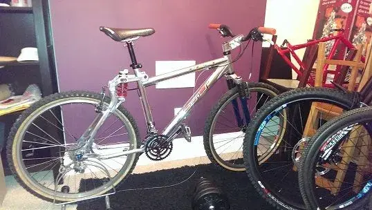

Any tips to get a trunion mount to budge on the shock? penetrating oil? swearing at it? buying it a beer?

Hey buddy, trunion was spinning fine on the shock, you turning it the right way? Easier to turn 180degrees off the bike so it's facing the correct way.
The travel chips are also the other way one mine. Below pic shows this and correct orientation of shock. See adjuster directions top and bottom.
Ah I see, I've spun it round to access the dials now cheers. Had another go at turning the trunion, I think it must be the air I Birmingham! It's no problem, I was just inquisitive about the angle changes.
I've gone with the travel chips in the short travel setting because I'm using such a short travel fork, does that sound sensible or would you recommend trying it into the longer setting anyway?
