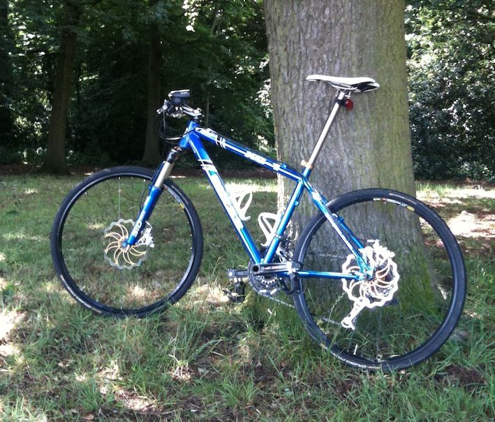

Here's what it looks like currently...
Hi, I've just got a brand-new Guess XC1 frame (apparently the last one Rock&Roll/Onza had) which I'm hoping to build up into my first 'decent' bike. After initially being blown away by how light it is compared to my current bike. I've started looking for components to start building it up.
What headset have people used for these frames? Rock&Roll said it was built for an integrated headset (and it has what looks like 45 degree bearing surfaces machined in the headtube), but it's 44mm ID/50mm OD and I can't find an integrated headset that size anywhere. It's the right size for a 44mm zero-stack internal headset, but it would need to be a very shallow one as the 'bearing surfaces' in the head tube are only 3.5mm from the ends.
The other thing is the seat tube is 30mm OD, which doesn't leave much choice on seat clamps. Rock&Roll sell a bespoke clamp for this frame but it's a bolt type, and I'd quite like a QR. Has anyone got any suggestions for a 30mm QR seat clamp?

blinkin flip, you sure that frame is not soo small for you? :shock: not seen that much seat post extension for a while...... plus the disc rotors look unnecessarily big - I bet I weigh more than you and mange on 160/160 and on 160/140 (cross country stuff, no mad downhilling)
