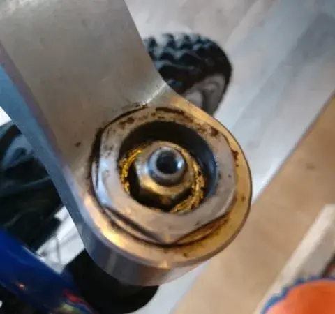

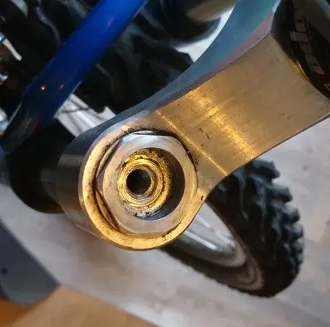

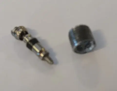

What came off...
What was left behind.....
Which I removed with an odd size socket.....
To reveal what appears to be the bit I need to replace....
The broken thready bit on the top goes in the pump, the other end threads into the top of the cartridge.
And it all looks to be a single piece that the valve core slots into, so now I need to work out whether this is a generic or specific part.
I'll try to get a read on the threads, that might help I suppose.
Then see if it can be replaced

I'm afraid that valve is properly "forked"... You will need to salvage a part from some old Englund total air cartridge. There are single valve units available for automotive suspension applications (Oehlins for example) but I'm afraid the thread and taper on the un-broken part are different (taper pipe thread finer pitch).
Didn't see that exact one but a quick ebay search for "shock valve schrader" brought up a few similar. Even if I gave to bodge /modify it may be a way to go.
