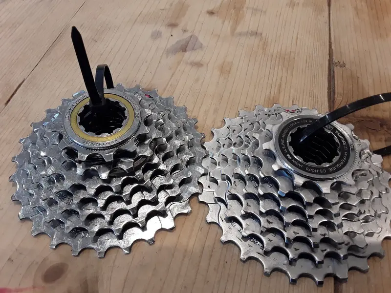

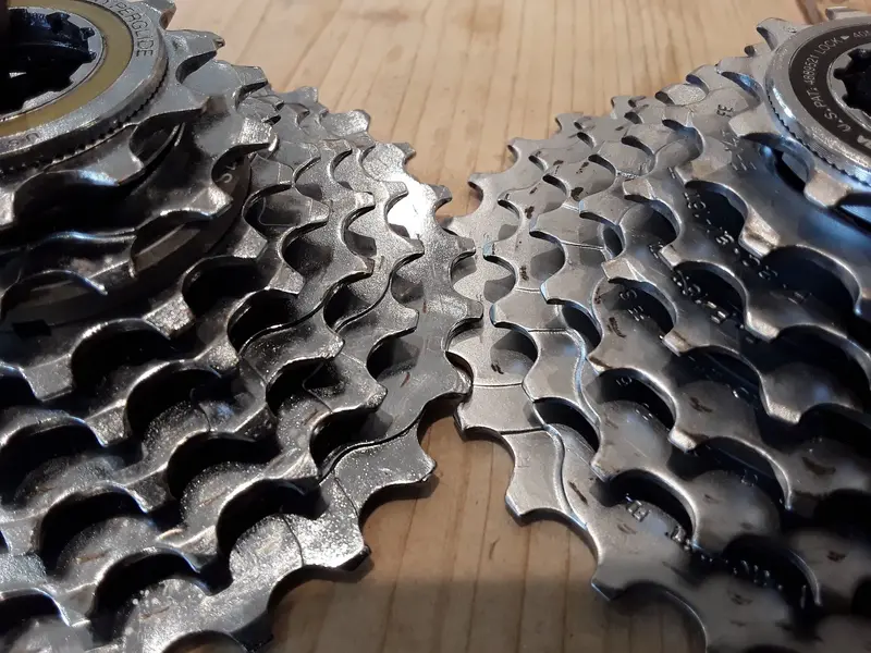

Whilst this will be old news to most of you old timers, I've noticed a lot of cassettes on ebay recently being mis sold as HG90 or HG70 when they are not. These cassettes now go for premium ( or silly as i call it) money. I would hate to see a fellow retrobiker end up dissapointed.
The 7 speed era cassettes from around 1990 have different finishes to them, although this can be hard to see in isolation or if dirty.
Whilst i have one of each cleared up, i thought i would post a picture of the difference.
The main thing is the finish coating on the cassette as all the cogs are stamp formed in the same way.
HG90 XT spec, have an chrome mirror finish to them. The cogs are no different and the finish is purely for advanced corrosion resistance..
HG70 Deore spec are still shiner than the lower grade cassettes, but are zinc / nickel plated.
Both weigh in at around 320g
Keep you eyes open. If want a genuine XT HG90 i know bicyclist.cc did have them a while back for reasonable money.
All the best.

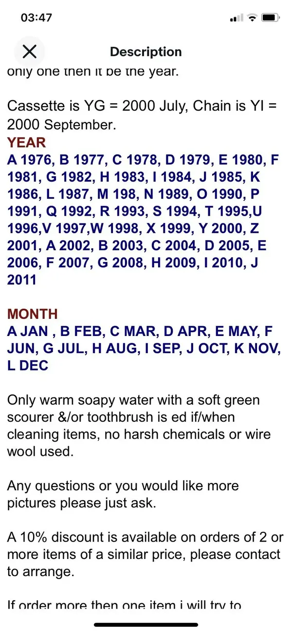

Are there no id numbers anywhere on cassette??
Came across this for identifying year of manufacture but don’t know where these numbers are,perhaps someone with more knowledge could help..
Bicyclist are out of stock..🤦🏼‍♂️
I dont think cassette had a date stamp.....well not that I've noticed! There are E numbers, but i assume this is for identifying the cogs? All shimano cassettes seem to have these regardless of age. There are also other random nunbers and letters, but they dont seem to be date codes.
In fact the one above is stamped FE, but i doubt its may 81 or 07!
Cheers
Yeah stared out as a simple I need a 7 speed cassette replacement..bit of a minefield with people claiming it’s a hg70 of 90 and some clearly not..
The xtr stuff is clearly marked..
I’ve decided that year date table is useless..🤦🏼‍♂️🤦🏼‍♂️
