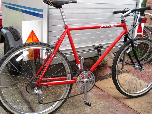

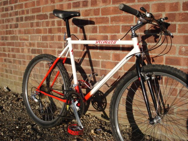

It takes years of practice to balls it up professionally but rattle can jobs can look nice.
these are wot idid...
