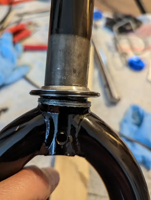

I'm having trouble installing a crown race for the first time. Any tips?
If you have a large enough ring spanner, you can align that on the flat face of the race and tap the spanner arm. Another option is plastic tubing over the steerer and on to the race, hit that with rubber mallet to seat race.
Then there's the lump of wood approach too.
Cheaper tools than park available, no substitute for a proper tool or home brew equivalent.
