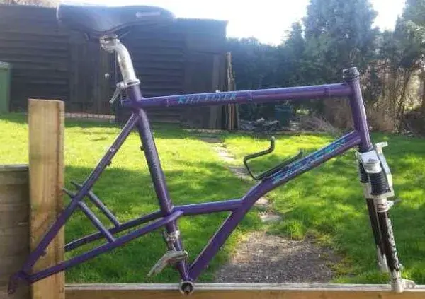

Watch this space. Pic from sale thread. Yet to arrive. Yet to be christened. Why do i like it?

Re: Incoming Saracen Estay 92 Kili Flyer ARRIVED help please
The donor
DB Post is 30.0 saracen is 30.2 is this too little difference for a coke can jobbie? Solution please if you have one.
