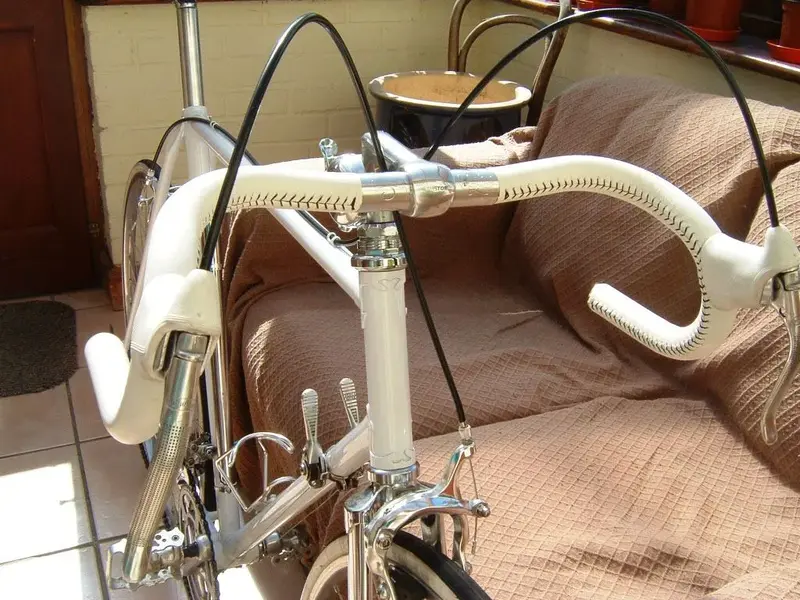

Also did some almarc style bar covers for it

That does look nice, exactly the same frame as mine I think. That style of covering on the bars always looks great, but I suspect it wouldn't if I tried it.

@Goldie, many thanks. I don't' really like stickers and decals, so I thought I'd keep this one plain :-)

As for the bar covering, I thought I'd have a go. You do need a lot of patience, and I had to restart more than once, but when you get going it's not hard. The most difficult bit was cutting around the boss for the brake levers! I got there in the end and am chuffed with the result.

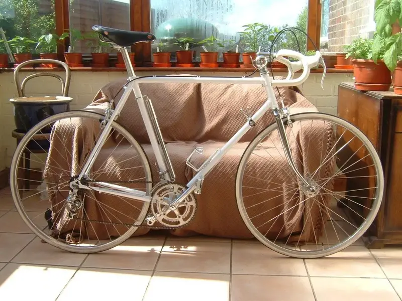

Long term project. This is my girlfriend's 1970s Galaxy that, to become a proper work bike, needs updating. Questions to follow. So far I've fitted proper " working " brake levers instead of the safety-deathtraps in the piccie, 8 speed indexed barcon shifters ( obviously set to friction at the moment ) and I know I have to respace the rear end from 125mm out to 132.5mm and fit something like 70-80mm caliper drop brakes when I fit the modern 700c wheels and fit a moo-hassive 127mm bb when I go with a modern-ish and triple chainset:
Question. Am I missing anything? Is there anything else I should be doing to the frame?
mrcpea, that is bloody gorgeous. Not sure I could cope with all that white but looks stunning.
