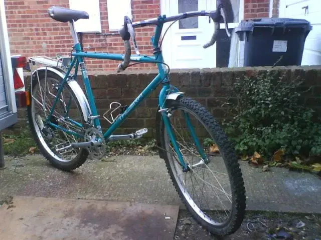

You say your machine is inspired by this thread, but I don't get it. The handlebar/saddle distance should be short ~ never mind the height; a high front end does not necessarily mean a rearward weight bias. Then you slip in the phrase "lazy angles". The angles in a frame are meaningless ~ they had relevence in the days when frame builders used the top tube as the datum. It could be generally said that steeper angles from the horizontal top tube would make a 'faster' machine, and less steep angles, a 'slower' bicycle. But this is such an over-simplification as to be so much bollocks. I can expand on this at length, but only if asked. In straightforward terms: frame angles alone mean nothing, unless you can relate them to other factors/dimensions.
