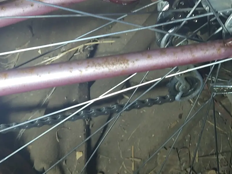

Just bought a Carlton Giro
I have been debating with myself the best way of cleaning the surface rust from the paintwork. I think WD 40 and then aluminium foil will be first then maybe some white vinegar to convert the remaining rust. Is there a better way?

Well had a little play with pocket rocket and aluminium foil on the paint. After about 2 minutes it had done this. Will do some more like this then treat with rust converter and see what it looks like. What surprised me is that while it is definitely moving the rust off the paint it is not really scratching the paint. Hopefully from the before and after photo below you can see some difference!

When you say "pocket rocket"... are you saying a micro sander? Dremel? Please clarify as I have similar issues on my Carlton Corsair! As it's 42 years old I have reached the point where I was going to try some T-Cut treatment but I'm interested that you seem to be having success with aluminium foil, galvanic?
