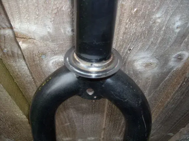

Anyway, here come the questions I promised. First - whats with these bits on the forks? Theyre part of the headset no? How the hell do I get them off without busting them up?

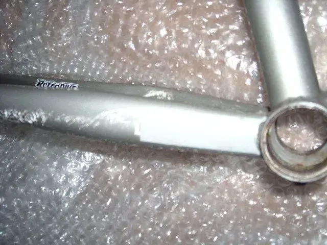

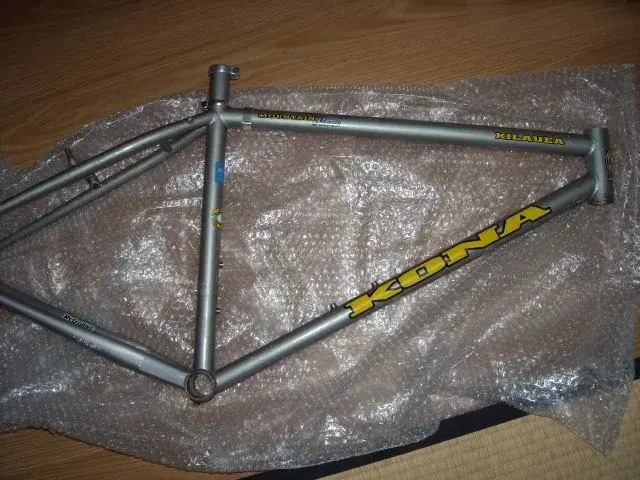

Whose is this frame??
Secondly, who used to own this? Hehe. I got it off ebay the other week.
Ive been looking at the bits coming off the 'dome and thinking that the frame is worth newer shinier stuff. Im gonna use the bars, brakes, thumbies, front mech, BB and cranks for sure. Not sure about the rest. Im thinking of getting modern wheels, seatpost, casette and chainrings.

That looks like the crown race on the top of your forks. They are pressed on and quite tight but you can generally ease them off by working your way around a little at a time with a hammer and old screwdriver (the ultimate bodgers combination).
If you're unsure, take it to your LBS so they can break it for you :D .
