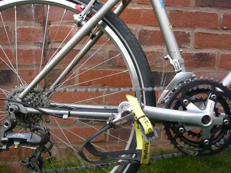

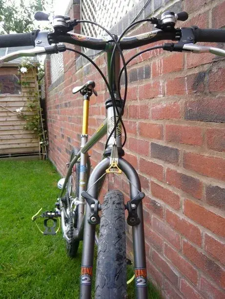

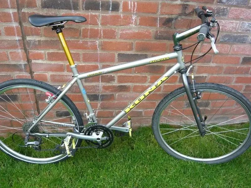

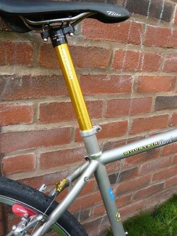

Here are some photos of my first ever build. it goes very well and weighs in at a little over 23lb. I know it's a mish mash of old and new and it cost me more than I was expecting but I'm well chuffed :D :D Thanks to everyone for your help and your parts donations :wink:
Matt

I would agree with Neil there. It's quite an interesting marriage of elements that weren't born together. A 1994 frame, a 1996 fork (that is geometrically compatible) and 1995-style decals that are not 1995 Kilauea decals (which were silver grey, although some other 95 Konas had yellow decals) - but it all goes together well.
The only thing I disapprove of is the over-long stem. A 1994 size 18 Kilauea came with an 11cm stem, and anything longer is going to take the edge off the steering. Could be what you like though, and it's your bike after all.
Only think I would change is the stem too, but not on account of the length (if it fits, thats fine)... its just that the colour doesnt go. Either same colour as the P2's, gold to match the post, or matched to the frame
Otherwise, its a job well done
G
Not sure about Kona's spec but a non setback post is going to put your weight and position in relation to the BB to far forward if that frame was not designed around it. JMO.....

Thanks for the props guys. Pleased that it is approved of :D I know what you mean about the stem. That one I had lying around and popped it on temporarily. I think its staying put now though due to the game I had getting the bars into it. Also, I've been finding it quite difficult to get hold of a decent stem that isn't hugely long.
