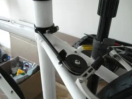

Just thought I'd stick this up. I did have a flexible noodle as suggested by southbound. In theory these should work well, however the one I was sent was different from the advertised item and had a big ugly plastic section where the cable met the noodle part. I no they exist with just the small metal sleeve as i've seen them but do check if you go this route as the plastic sleeve eliminates the flex to much on smaller frames.

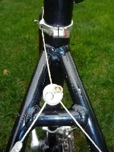

This is my final solution- a Problem solvers Travel Agent. It works great and allow very smooth cable movement. The cable guide is also drilled a few mm to take the cable outer.
a travel agent alters the cable pull
a cog hog achieves the same results but with the added bonus of not altering cable pull
The travel agent only alters te cable pull if you use the inner and outer wheels. This is for using Cantilever levers on V brakes. It transfers the pull round the small wheel to the big wheel thus gearing up the pull length. If you just route round the big wheel its fine and just acts as a guide like a noodle.

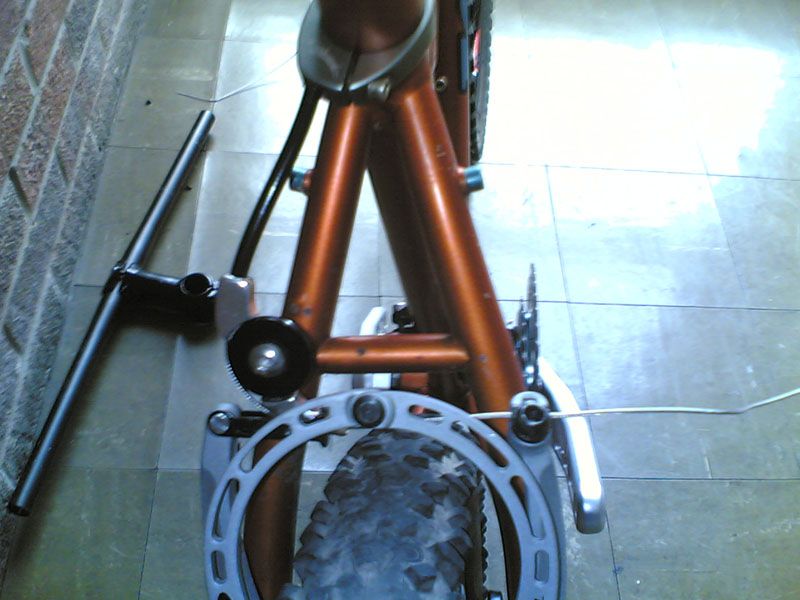

Here's a picture off a 95 AA. Got it off auction recently and have not cleaned it up yet.
