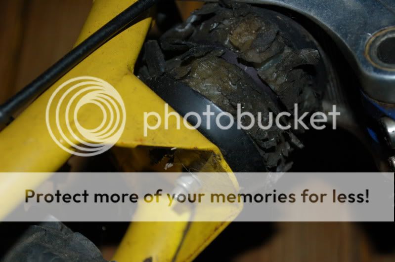

Can the higher spec rear shocks be used to replace the elastomer?

No, I don't think they can. They have a different pivot point - the top pivot to the frame is higher, and the top linkage (called the Trunnion on post-96 high-end models) is longer.
If you're happy to hack up a bargain bike, then something could be bodged, I'm sure!
i'm told skate board truck elastomers fit these
i dont know if they're any good but gotta be worth a try

Rear elastomer is shot

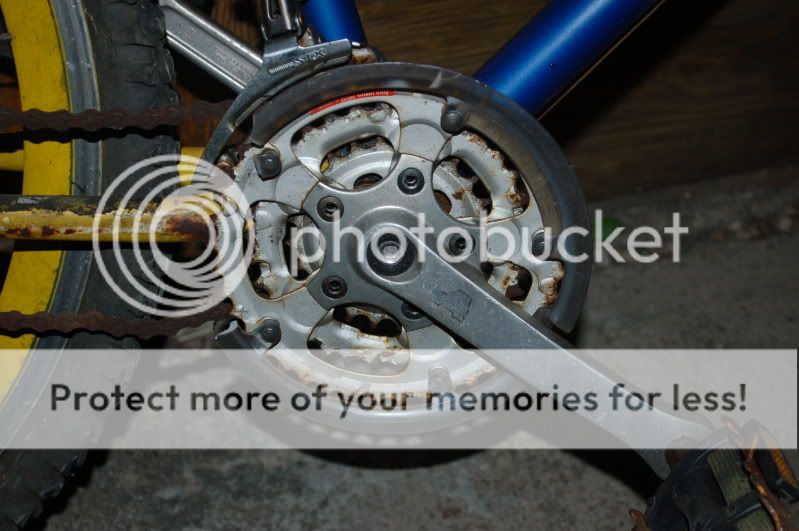

Cranks only fit for the bin

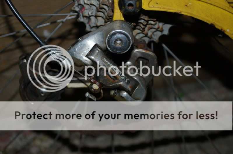

Front and rear deurallier should clean up ok

It's now in component form in the garage while I decide what to do with it (any suggestions) the only issue I have is removing the non-drive side arm, the threads are shot so my puller won't get hold of it. Any tricks to getting this off without damaging the BB?

for the crank arm, take the bike and your puller to a local engineer and just get hem to re-tap the crank arm. it should work, failing that use heat on the tapers & 'chisel' it off from behind with a lump of hardwood and a hammer.

I've had a 2 arm puller on it heating the arm and it stayed put. Annoying really as the drive side slid straight off without an issue.
I don't mind destroying the arm, I just want to make sure I don't damage the frame or the bottom bracket. Has anyone tried cutting the arm and splitting it with a cold chisel?
I've got a spare left side Alivio arm you could have for postage if you want, but tbh Alivio cranks aren't worth worrying about and the bb is a LP26 that you could replace for pennies.
