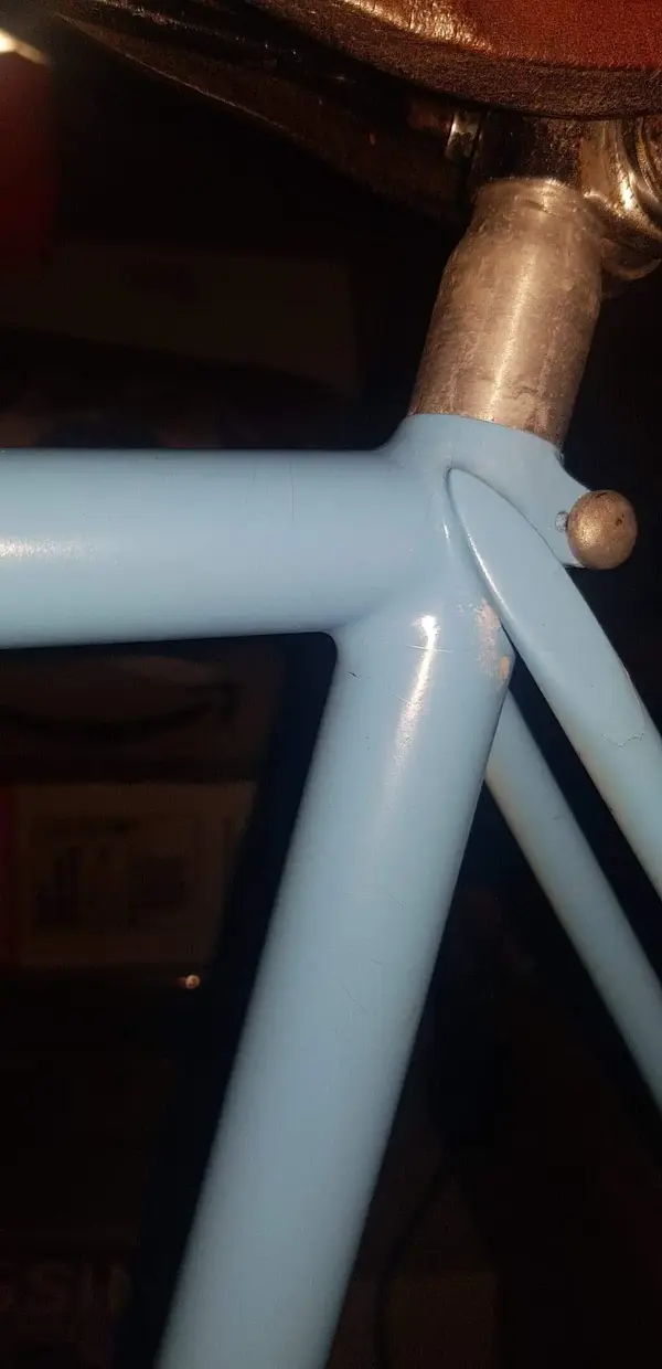

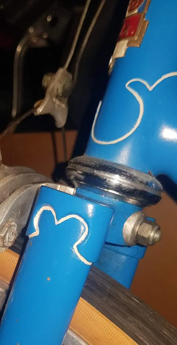

I have a Hobbs,c1950's, which seems to have a combination of lugless and lugged joints on the frame. I have been told that it should have either one or the other and not a combination of the two. Unfortunately I can't find a frame number and was wondering if anyone has seen this before on a Blue Riband? Any help is appreciated.

The frame has been resprayed by my late Dad so whether he has sprayed over the frame number. I have posted s couple of pics

Frame number will be stamped on the non-drive side rear drop out, paint looks like a rattle can job so just rub some paint off to reveal the number - it will begin with a letter.
